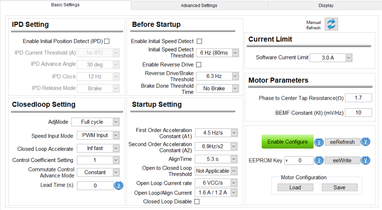

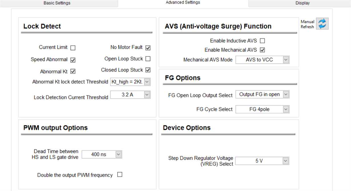

  • Hi Jay,
    Thanks for the question. I plugged in the register values you provided into the DRV10983EVM GUI. Can you confirm if the below data is correct? Also, can you share your motor parameters to make sure the registers are configured correctly? The two images that you shared are broken. Can you re-upload them?

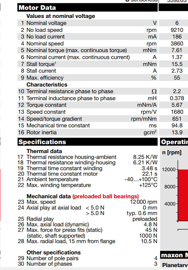

  • Hi Jay,
    Thanks for sharing the datasheet. From the datasheet I see that the nominal voltage of the motor is 6V but the min motor voltage that is recommended in DRV10983 is 8V. I still think we can give it a shot. Can you check the GUI screenshots in my previous post to make sure the configuration looks right? I see that open to closed loop threshold is not configured. From the datasheet, Rm (phase to center tap) = 1.1 ohms and Kt = 8.9 mV/Hz. Can you configure open to closed loop threshold to 90 Hz and Rm and Kt to the datasheet values and try again?
    Vishnu

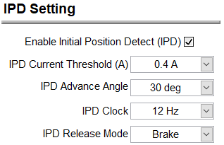

  • We've closed the loop. We can start it all at once.However, when starting, there is a phase seeking operation for the motor, which will cause the motor to reverse or shake a little, which problem should be adjusted?
  • Hi Jay,
    Good to know that you are now able to spin the motor in closed loop. The motor shakes during startup because we are using "Align" as the startup method. For applications where a reverse spin is not acceptable, we recommend to use Initial Position Detect (IPD) function as an alternative way to initialize the motor. You may use the below IPD settings to get started. Please refer to the tuning guide section 7.1 for more details on tuning IPD.
    Vishnu.
