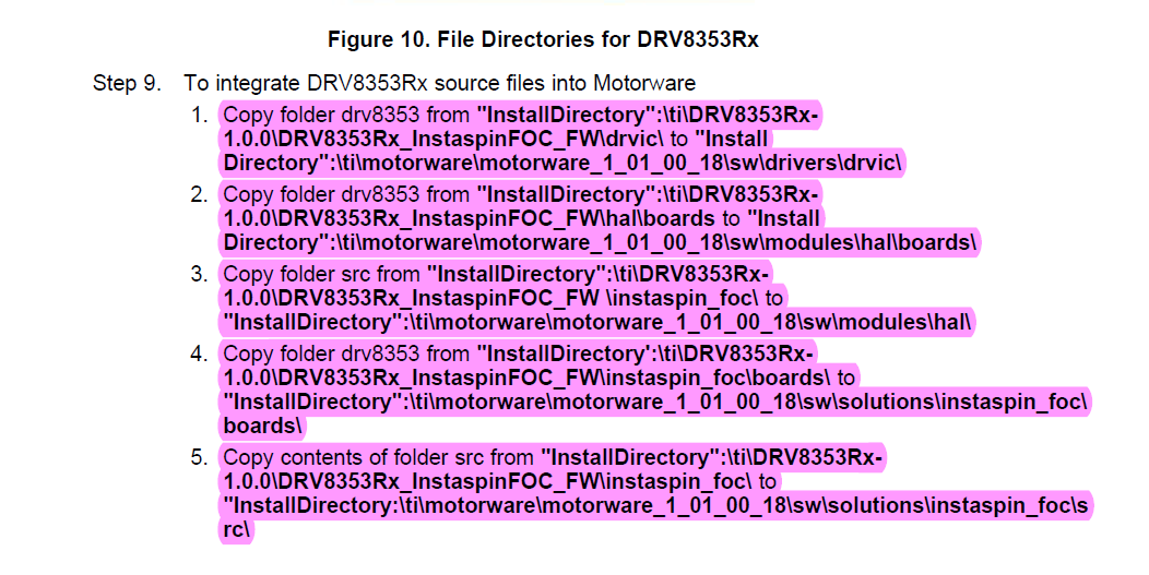

As per the User guide of DRV8353RS-EVM, I have extracted the code file DRV8353Rx-1.0.1.
(D:\ti\DRV8353Rx-1.0.1\drv8353Rx_instaspinFOC_FW\drv83xx_foc\instaspin_foc\boards\drv8353\f28x\f2802xF\projects\ccs\proj_lab05b)

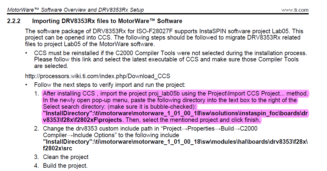

Using above mentioned directory, I have imported the code to ccs for compilation. based on the following user guidance image.

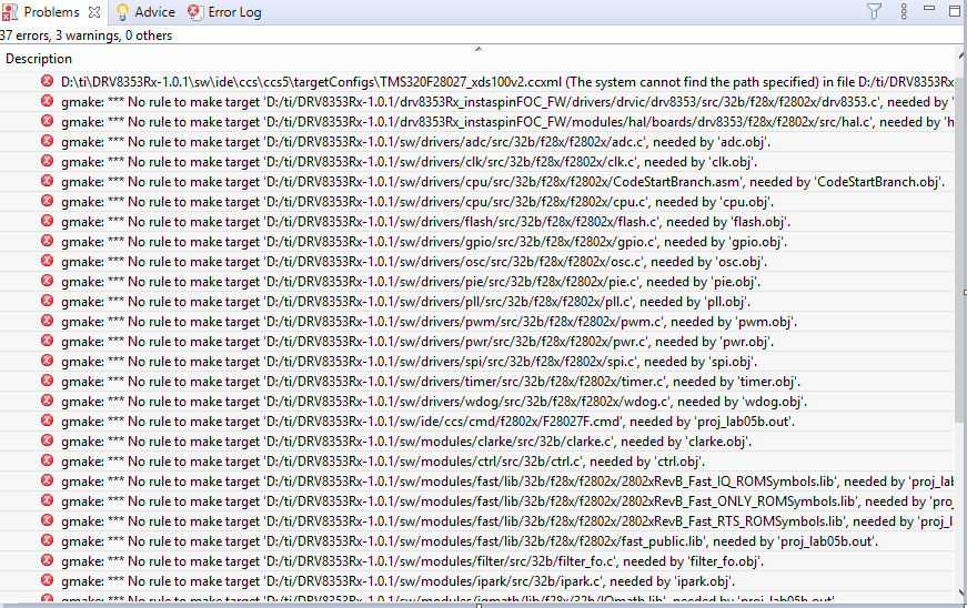

In the image highlighted step 1 to import the code and compile in CCS process, I got 37 error and the newly pop menu which mentioned in the above image is not appeared.
For error, please check the below attached image.
