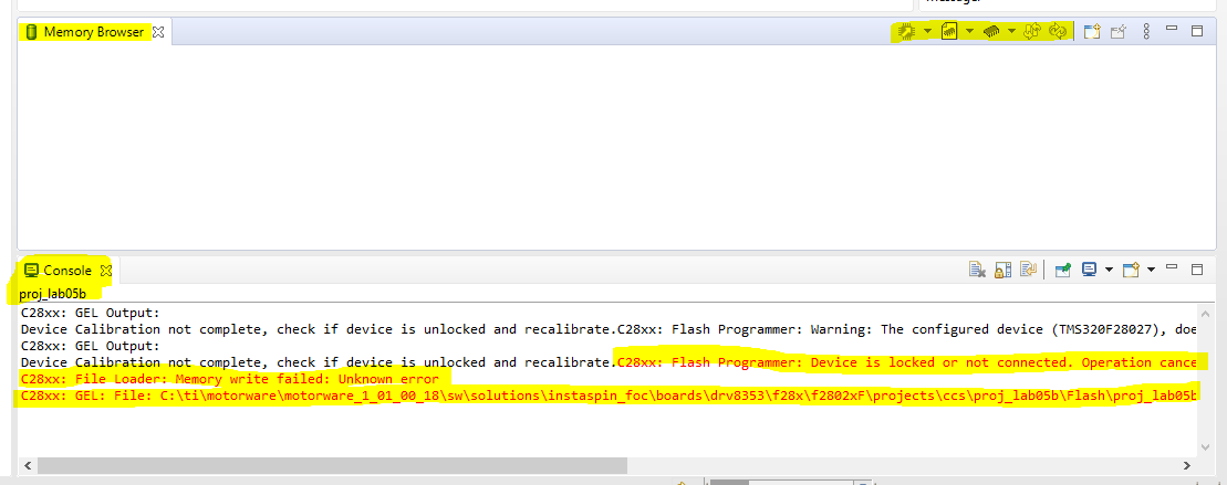

Dear TI Team,
Currently I'm using DRV8353RS-EVM and as per the TI user guide DOCs I have followed and Tried to compile it but some errors are appearing (Error: C28xx: Flash Programmer: Device is locked or not connected. Operation cancelled).
Also checking the issue in the E2E support Forum, some suggestions are Power Problem (brown out) and Memory Lock.
I am sure, no memory lock is used before and while checking with Memory Browser the icons are not in active state.
Please help me to solve the error and share how to activate the memory browser icons in CCS.
I have attached the error image and memory browser image. Hope to reply soon.

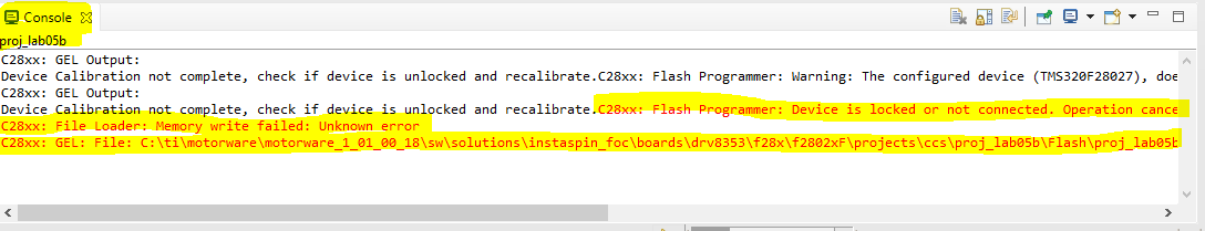

  • Hello Matthew
    Thanks for your reply.
    As per your instruction, I have followed and device was connected and you mention to open the memory window, in CCS View->Memory Browser only available. So, the connect through .ccxml is done but no memory window, instead of Memory window I verified with Memory Browser (entered the location 0x3F7FF8 - 0x3F7FFFF) and it shows '-' for all memory space no values are attached below as image.
    While Debugging I am facing some error that also attached below and justify the memory browser shows the normal or not.
    Please find the attached image and provide the solution immediately.

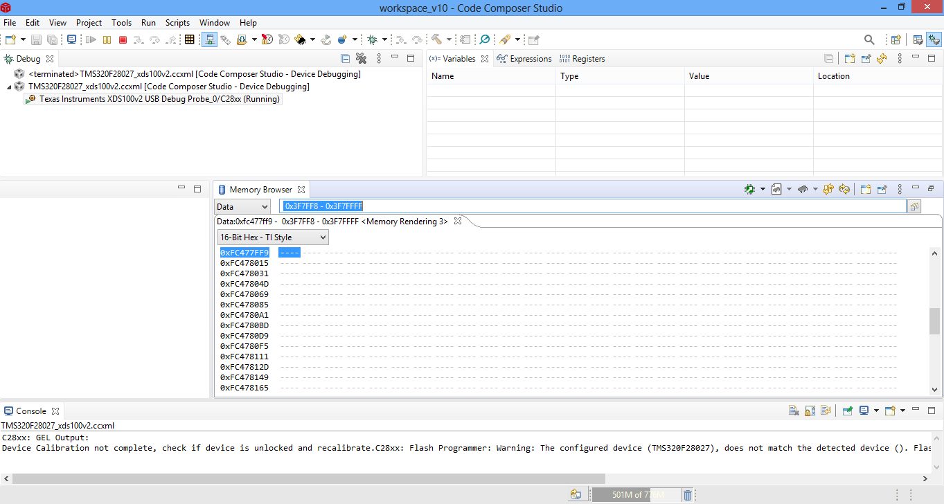

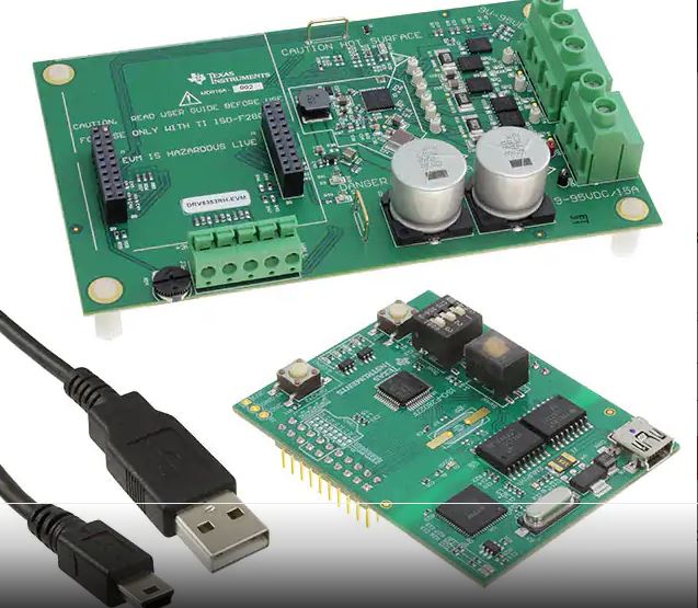

  • Hello Matthew,
    I have followed your instruction and observed the results are attached below.
    DRV8353RS-EVM kit image also attached for your reference, there is no JP1/JP2/JP3.
    Kindly check and provide the solution.

  • Ramyaa,
    I'm going to pull in some other team members from the motor control team inside C2000 to comment on the launchpad here, etc.
    From your memory window the device is indeed locked(all 0's in the password locations).
    Ultimately you will need a new LaunchPad, but I need to understand better the correct HW to point you to.
