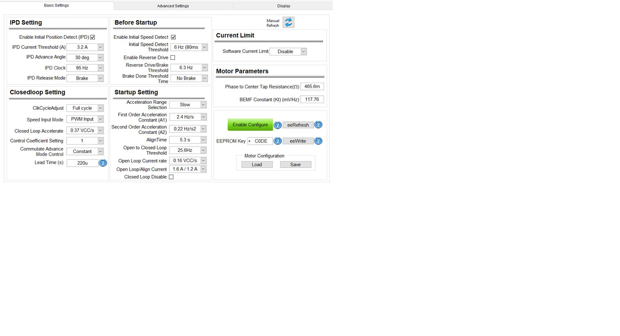

    The Motor parameters & screen shot of DRV10987 GUI are given below:

    We are not able to increase the motor speed above 52% duty cycle. If we incraese above motor is getting shut down.

    Thanks for sharing the motor parameters. The GUI screenshot image is broken. Can you re-upload the image? How much is the phase current (peak) that you are seeing at 52% duty cycle? If the peak is 3A or above, then we will have to tune the lead time. Can you try changing the lead time till the estimated Kt matches the programmed Kt ? Refer to this app note on tuning lead time.

    Thanks for sharing the GUI screenshot. Since your motor is rated for 1.5A (rms), I recommend reducing the IPD current threshold to 2A (peak). Since Rm (ph-CT) is 0.65 ohms, can you program Rm to 620.8m (closest available value to 650m)? Can you measure Kt to make sure 117 mV/Hz is accurate? Here is a video on how to measure Kt using oscilloscope. Can you try changing the lead time till the estimated Kt matches the programmed Kt ?

    As suggested, I reduced the IPD current to 2A and Rm is set to 620.8m.
    Also I once again measured the Kt, which was coming in between 100 - 110mV/Hz. Now the lead time is set to 220u.
    With these modifications, above 50% duty cycle motor is shutting down and lock code is displaying current Limit error.
    Please let me know what further do I need to adjust to achieve the required RPM without shutting down the motor.

    Tuning low resistance motors could be challenging. With software current limit disabled, low phase resistance motors draw very high current and trigger current limit. To avoid this, it is recommended to enable software current limit and set to maximum peak phase current at maximum speed with full load.
    Sometimes, because of the implementation of the software current limit, the motor might not be able to accelerate to the target speed. In such cases, the Speed Command Buffer will be lower than the Speed Command. This is because the programmed Kt value is wrong and set too low. The solution is increasing the Kt value and checking whether the motor can reach maximum speed. If the difference between Speed Command and Speed command Buffer gets closer, continue increasing the Kt until both are same.
    Vishnu.
  • Hi Sir,
    Based on your suggestion, I have enabled the software current limit and then adjusted the Kt value to make the Speed command buffer same as the speed command.
    Now the motors are running fine without shutting down. Also we were able to achieve the required RPM.
