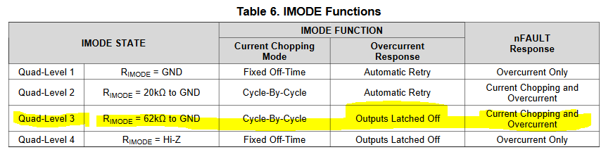

I'm driving a 12VDC motor using a DRV8876 controlled by an atmega328p and find when using a high PWM duty cycle coming out of my PID controller, the driver will tend fault on startup (either right off the bat, or after a few stops and restarts).  If I limit the PID range to around +/-70, it doesn't seem to fault.. but when I get above that, it does.  I have it configured for cycle-by-cycle/latched output (quad-level 3) mode.  I'm certain its not current-chopping since I can cause that to occur by changing Vref and the fault that appears clears on its own.  With the high PWM, when it faults and stays faulted and the only way I've been able to clear the condition is to power cycle (remove and reapply Vm).  Looking at Table 7, I'm not sure what the cause is:
When the atmega detects the fault (one that has lasted longer than 500 ms and there's been no change in motor encoder reading .. this is to avoid messing up working current-chopping routine) then to clear the fault, it brings nSleep High, waits 2ms, and brings it Low.  nFault clears after doing this.  However, the driver still seems to have its outputs disabled.  My understanding is that with fault cleared (and the condition removed), operation would resume.  Reviewing Table 7, I would think both Vulvo or Vcpuv would clear on its own pretty quickly since the motor is stopped and the power supply should recover.  A TSD would clear when the temperature drops, but I don't think its TSD since it can happen right on startup.  The only thing perhaps then is OCP, but doesn't that clear on its own as well? This issue doesn't occur when driving smaller motors.

    It looks like  this is an OCP fault. You have the IMODE configured to Quad-level 3 (R_IMODE=62kΩ to GND) which sets the OCP nFAULT response to LATCH. This means that the outputs will be disabled and nFAULT will LATCH when an OCP event occurs. A device reset will be needed to re-enable the H-bridge and resume operation. In case that the in-rush current during start-up is higher than the OCP threshold, the OCP event will disable the outputs again and another device reset will be required to resume operation. This process will repeat unless the current is regulated below the OCP threshold. To set the OCP response to automatic retry, the IMODE needs to be set to Quad-level 1 or 2. This ensures that in the case of OCP fault, the outputs are re-enabled after t_retry expires (section 7.3.4.3 on datasheet).
    Changing the IMODE to Quad-level 2 (if you require Cycle-by-Cycle current chopping) should prevent the nFAULT from latching in the case of an OCP fault.

  • John,
    The description on the datasheet is correct when the IMODE state is set to Quad-level 3 or 4 as you can see in the table 6. In your case, I think what is happening is that when you reset the device (by toggling nSLEEP Low-to-High) after nFAULT is latched, the outputs will be re-enabled but most likely because of the large in-rush current during motor start-up, the OCP fault is triggered again causing it to appear as if the the outputs have remained disabled.
    You mention that by decreasing the duty cycle or when using smaller motors that don't draw a lot current, this issue does not occur. By decreasing the duty cycle, the initial start-up speed (which causes the in-rush current to be below the OCP threshold) is lower which does not trigger the OCP fault. Similarly, smaller motors will not cause large in-rush current.

  • Hi John,
    I understand your concern. I recommend changing the IMODE to 20kΩ to GND to set the OCP response to automatic retry. This will ensure that in the case that an OCP occurs, the driver will clear the fault until the OCP condition is removed. The driver will resume normal operation without the need of cycling VM. However, if the OCP condition is persistent, the driver will remain in the retry phase keeping the outputs from driving the load until the OCP condition is removed.

  • Hi John,
    I want to confirm a statement you made in the original question. You mention that to clear the fault, the  controller "brings nSleep High, waits 2ms, and brings it Low". Is this correct? If you bring nSLEEP back LOW, then the device will be in sleep mode which would explain why the outputs are not re-enabling while it appears that nFAULT has been cleared (since it is pulled to external supply). The correct procedure for clearing the fault by using nSLEEP is to first bring nSLEEP LOW for some time (t_sleep = 1ms), then bring nSLEEP HIGH to re-enable the device (wait t_wake=1ms before sending the control signals.
    In regards to the VREF voltage questions, this device can withstand an absolute maximum voltage of 5.75V. However, we recommended a voltage of 3.6V as we can't guarantee that the current regulation circuitry or other internal circuitry will NOT be damaged if a voltage above 3.6V is applied for  prolonged time. If possible, I recommend to bring down the Vref voltage below 3.6V.
