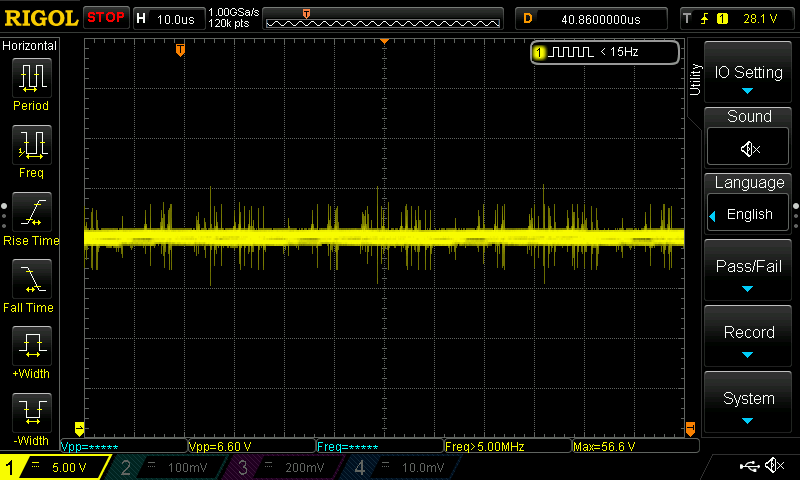

Have some oscilloscope measurements from voltage input and one motor lead, not sure what to expect.
As soon as motor starts turning there is a VPP at 6.6V, this increases to 10-11V at higher currents
There are two 330uF electrolytic capacitors and two 10uF ceramic on input.
 High load input voltage

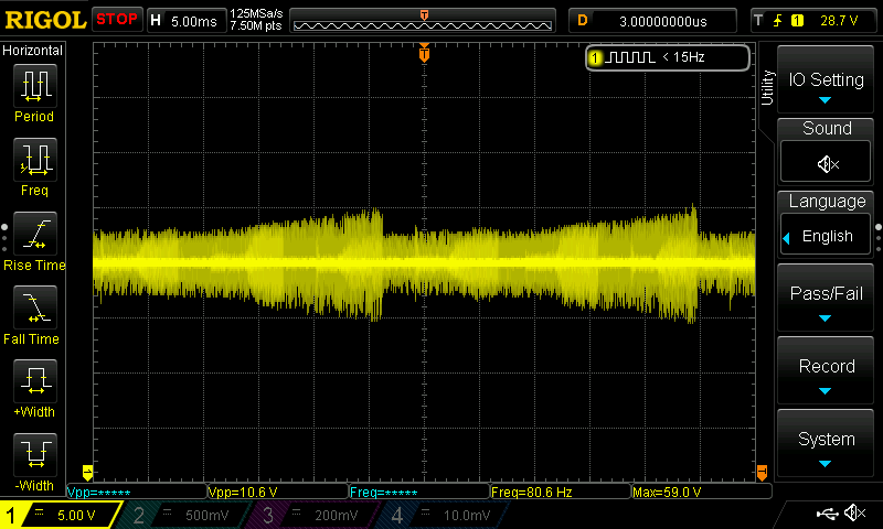

From one of the motor leads
Opposite rotation high load, no sure what is going on here?

    On your last waveform, this appears to be the motor in coast state. You can confirm this by looking at GHx, SHx, and GLx for this phase to see which FETs (if any) are ON.

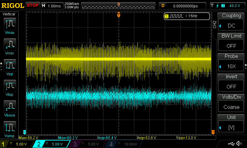

  • Hi Matt,
    managed to test VM and VCP, the other places are missing test points.
    A new board that’s easier to solder wires too will be ordered.
    I've included the results from VM and VCP.
    The acceleration and deceleration is based on how much input the user is giving as this motor is used to aid the user with a set amount of power based on input load
    Motor will never free spin.
    How does VM and VCP look?
    VM in yellow.
  • Hi Martin, VCP seems quite reasonable with around 2V of ripple during operation. You can always try sizing up the VCP capacitor or slightly increasing the rating of the CPL-CPH capacitor. I don't think these steps are needed. VM looks like it has +/-5V of ripple, which keeps VM below 65V during operation. Keep an eye on this one as you are only 5V away from the abs max rating of the part. It would be good to check SHx while switching, because I have seen cases where SHx can exceed VM due to trace inductance or slow high-side body diode conduction. You want to make sure SHx does not exceed the 65V abs max rating as well. To mitigate this kind of effect you would need snubbers. Since you are operating at around 50V, I would recommend a 100V rating on the VM ceramic bypass capacitor (0.1uF) and the CPH-CPL capacitor. This is so that you do not loose too much effectiveness because of voltage de-rating. Thanks, Matt

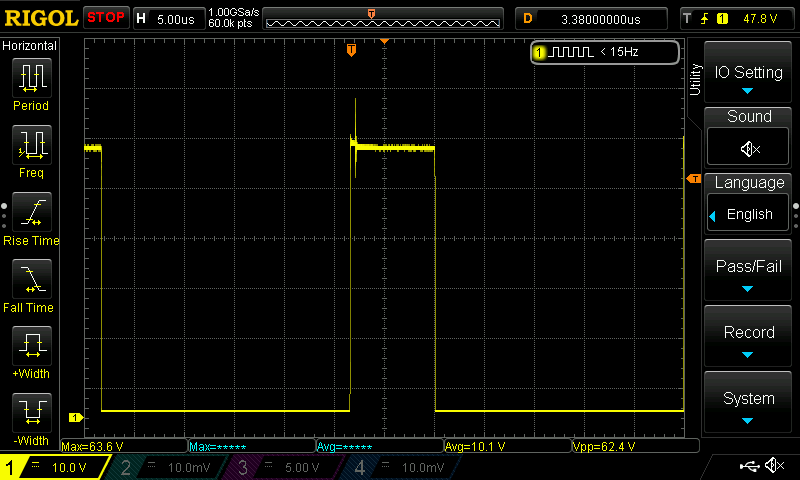

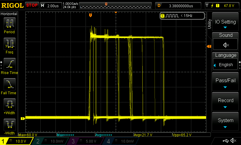

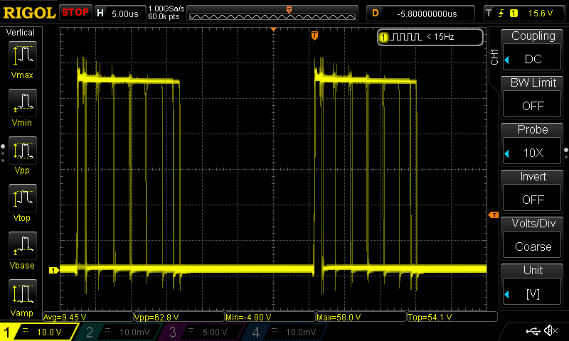

    Managed to solder a wire onto SH_C. Image below is the result.
  • Hi Martin,
    Thanks for these plots. You are certainly close to the limit with the coupled noise - 63.6V. I don't see any supply pumping beyond a diode drop (body diode of the high-side MOSFET). You may consider snubbers on the output to try to combat this noise (assuming it is not just an artifact of the scope).
    On the first plot I do see some significant negative voltage spiking (lower than -10V). This could be due to insufficient local bypass capacitance (high-side MOSFET drain to low-side MOSFET source) or too high slew rate for IDRIVE sink.
    How much sizing up of VCP are you thinking? It's 1uF now. --> It doesn't hurt to size up to a 25V rating (to combat capacitor de-rating).
    Matt

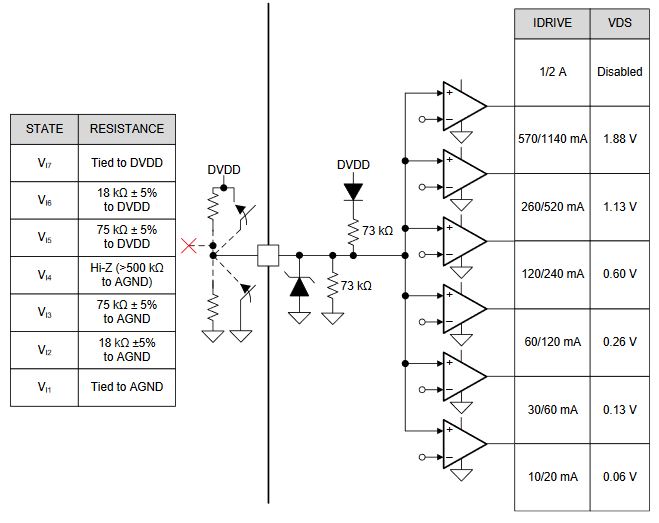

    IDRIVE is set to the same as EVAL board, IDRIVE = Hi-Z
    IDRIVEP = 120
    IDRIVEN = 240

    240mA may be a little aggressive give you are running at such a high voltage. You may want to consider stepping back on the IDRIVE setting. What MOSFET part numbers are you using? We can check the approximate rise & fall times by Qgd / IDRIVE

    Qgd is 7nC, meaning our rise times will be ~58ns and our fall times will be ~29 ns. It's a bit fast on the falling edge, and you may consider going to the next lowest setting. This may help reduce negative voltage spikes.

    so an IDRIVE setting of 30mA/60mA giving a rise and fall time off 116nS and 233nS?
    Martin
  • Hi Martin,
    I think you can do 60mA/120mA which would be about double the rise and fall times you are seeing now - the IDRIVE pin would need a 75k resistor to GND. The 30mA/60mA is the next lowest setting.

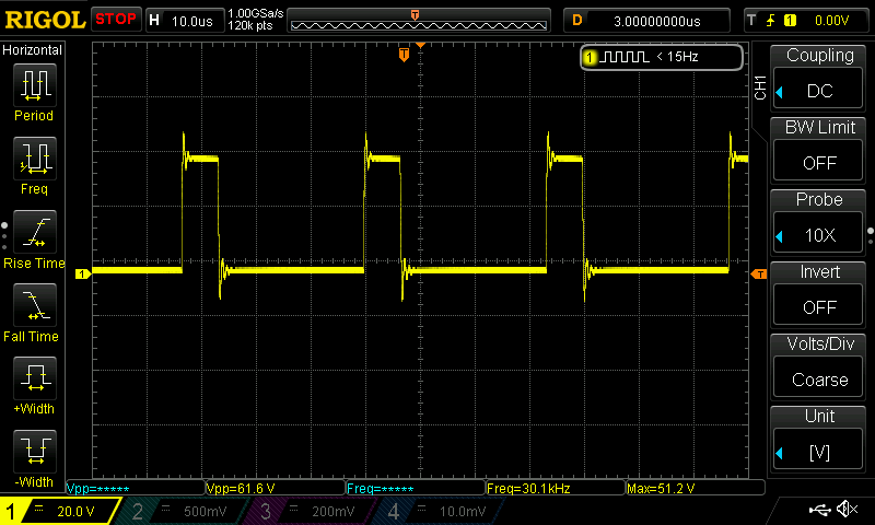

  • Hi Matt,
    Changed IDRIVE to your recommendation, didn’t look to make much difference on SH_C.
    Will lowering IDRIVE lower power usage for DRV8323 so it will run cooler?
    Is there a reason not to go back to the old setting?
    We have used the DRV8323EVAL board as reference at it has a 75K to both VCC and GND, not sure what IDRIVE we have used. Measured 1.6V at the IDRIVE pin.
    Image below is after change.

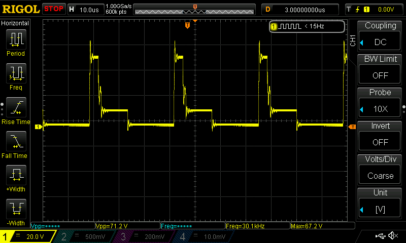

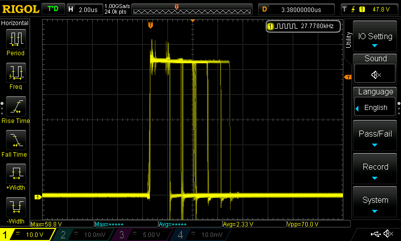

    Changed local capacitor from 0.01 to 0.1 100V and kept IDRIVE to same as above
    Images below is from both SH_C and from C output to motor with 0.1uF capacitor
    SH_C
    C_out

  • Hi Martin,
    Will lowering IDRIVE lower power usage for DRV8323 so it will run cooler? --> Unfortunately no, this is to try to reduce the switching spikes on SHx and other output nodes. the DRV8323 will still have about the same power dissipation. DRV8323 is single supply and so it will be generating all internal voltages from your VM supply and that means the power dissipation is high when you operate at higher voltages. Split-supply devices like DRV8353 allow for a separate 15V supply to lower the power dissipation inside the IC (see this app note).
    Is there a reason not to go back to the old setting? --> If there is no reduction in spikes, then you should use the higher setting
    If there is a reason to have a bigger value capacitor this will impact the cooling, since 0.1uF is the biggest 100V value in 0603. We will then need a thicker thermal pad below to make up the hight difference. --> A larger capacitor will do a better job to mitigate any inductance in the supply and ground paths, so more is better. The only issue with too large capacitance from the high-side drain to the low-side source is that your current sense measurement can be impacted at the beginning of the PWM cycle due to extra current from the capacitor.
