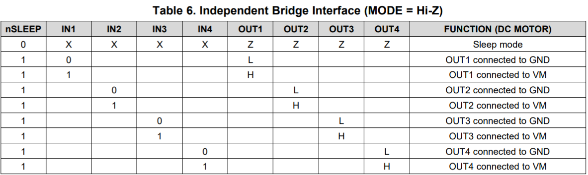

We are using DRV8847 to operate 4 relays. In the independent bridge interface, the DRV8847 device can operate 4 independent channel with 4 independent input PWM signal ?

Tarun,
PWM means pulse width modulation.
DRV8847 only has two current sense pins: ISEN12 and ISEN34. If customers want to use DRV8847 to adjust the PWM duty cycle according to the output current setting, DRV8847 only can support two outputs.
But, if customers can adjust the PWM duty cycle by themselves, DRV8847 can allow 4 independent channel with 4 PWM signal.
