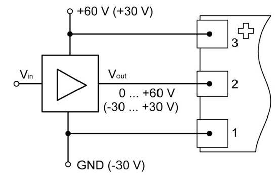

  • Hi Luis,
    Your last point regarding connecting 2 piezo loads opposite to each other is not entirely clear.
    The piezo bender can not be connected in opposite way. It has a + and – side. Please see below image.
    or incase I misunderstood you, can you please send a drawing/sketch of of what you meant?
     Also, can two of these benders be used on one chip considering the frequency range described earlier - 200-300Hz?
    Lastly, if the RV2700 will be too small wrt power (more current) for example at higher frequencies (400-500Hz) what alternatives would you suggest?
    Thanks and looking forward to your feedback.
    Obinna.
  • Hi, Obinna,
    Yes, I thought your bender had a differential input. The DRV2700 actually generates a differential output. With a differential input piezo, it could be used to move the actuator in opposite directions if the outputs are inverted (OUT+ to IN+ and OUT- to IN- with first device and OUT+ to IN- and OUT- to IN+ with the second device).
    The frequency range that you described is also supported. Actually, you may take a look at the typical characteristics from the datasheet for details about the supported frequency range based on the load capacitance:
    https://www.ti.com/lit/ds/symlink/drv2700.pdf#page=7
    Luis Fernando Rodríguez S.
