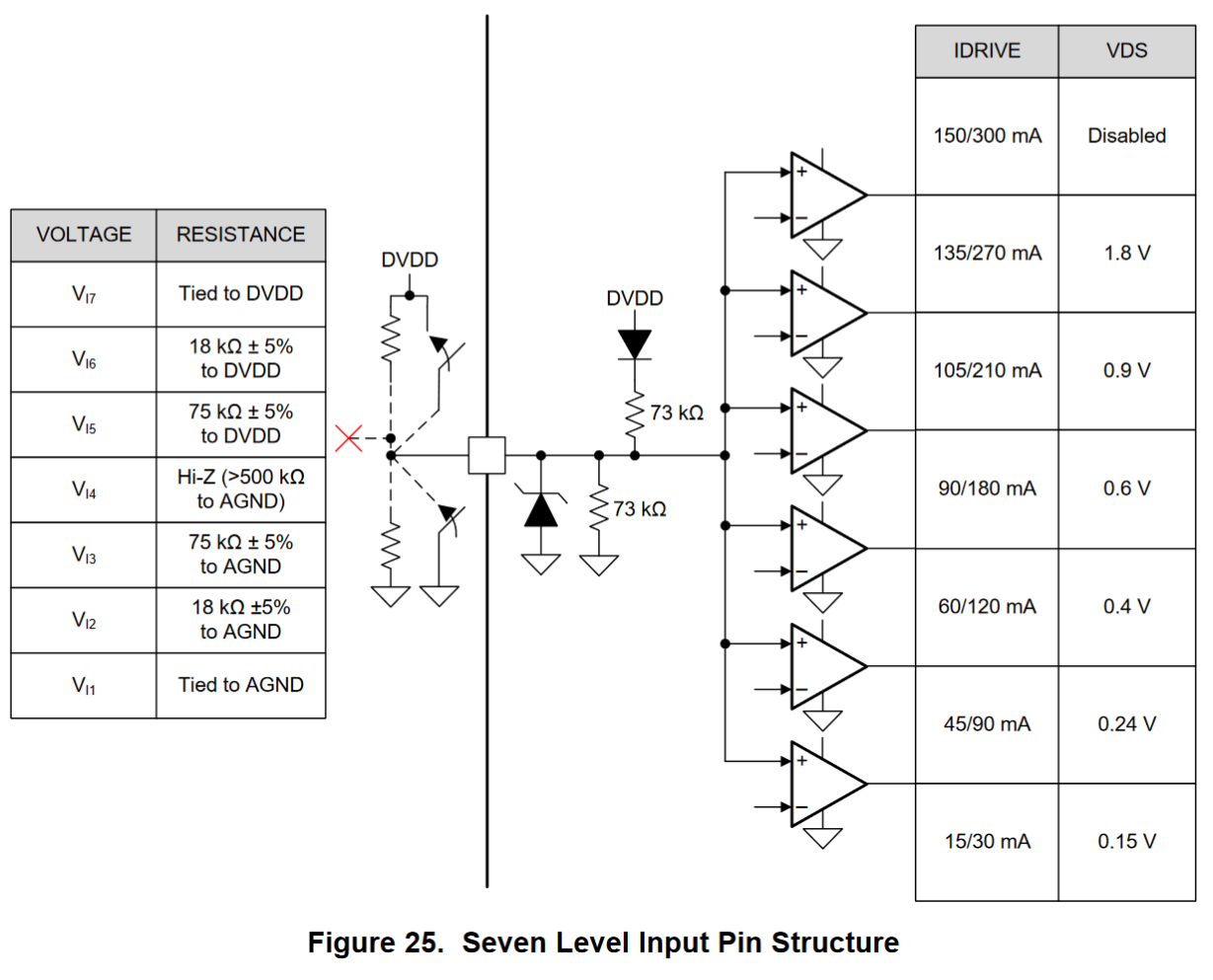

    1. I calculated IDRIVE setting at 130mA for a 200ns TRISE (as a starting point). This was based on a Qgd value of 26nC from the CSD88584Q5DC data sheet. So I can select the correct setting (120mA or 180mA), can you please confirm if the jumper setting closest to the edge is the 15/30mA setting? (so my settings would be 3rd and 4th jumpers along). There are only 6 jumper settings (and 7 IDRIVE settings), so I'm not sure if the 'no jumper' setting is min or max.
    Based on the layout, the "lowest setting" (15/30mA) of GND is at the edge of the board and the "highest setting" (150/300mA) of DVDD is the inside position of the header. The "middle setting" (90/180mA) of Hi-Z occurs when no jumper is placed.

    Looks like I have IDRIVE set at 120mA then which is good, I'll try 180mA today by removing the jumper.....but guess I'll need a scope to properly determine the best final setting.
