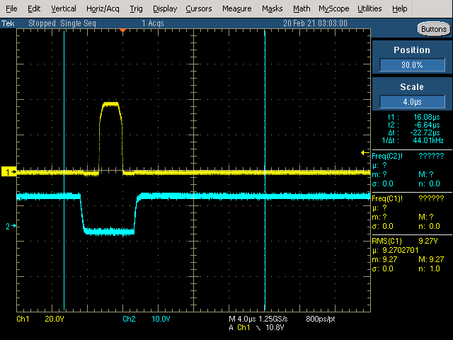

    I managed to get 2 pictures with Idrive=1 and Idrive=4, dead time=6

    I will try to get back to you tomorrow, but to start off I think it would be helpful to see an oscilloscope plot that shows all three hall outputs during operation when the motor is in normal trap 120 commutation. Additionally, it would it be helpful to see the plot of one of the phase currents with respect to the hall outputs.

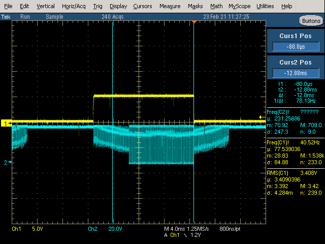

    I managed to get some screenshot from the oscilloscope.

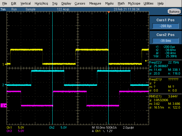

    First, the  3 hall signals, they look absolutely fine to me (infact the original driver works ok with the same motor)
    Then a screenshot of 1 hall and 1 phase of the original driver:
    If I don't set the polarity bit and delay bit on DRV8308 I have a similar waveform:
    The problem is with this hall polarity I can't have the DRV8308 to lock IN. Every time It tries to lock it seems it is "kicking back "
    and start again, even if it doesn't stop.

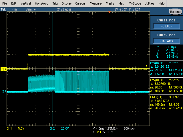

    Then I set the hall polarity bit and delay bit to 1, this is the unlocked status waveform:
    And this is the locked one:
    Unfortunately once again the transition from unlock to lock is not smooth and I run into the problems I told you about previously.
    I replaced the original mosfets with NVMFD5873NL, these have 8.8 nC of Qgd but nothing changed.....

    After reviewing your waveforms, I have a few comments and questions:
    As you mentioned, it looks like the motor performs better with the hall polarity = 1 compared to when the hall polarity = 0. Do you have the motor datasheet? We can double check some information on it that might be helpful.
    The delay bit doesn’t affect the motor operation until the device is operating in the Lock mode using single hall commutation.
    The waveform of the 3 hall sensors seem to be operating properly. Was that graph taken while the device was in lock mode? Or was that during regular 3 hall 120 trap commutation?
    Based on the second to last waveform you provided it looks like the length of time that the driver is in high-Z mode is much shorter than expected when it is not in lock mode. In order to help us further understand what is going on, can you provide a waveform showing all 3 hall phases plus the high side source of one of the phases during regular 3 hall 120 commutation? Also, if you could label the waveform to show which phase corresponds to which signal that would be greatly appreciated.

    I don't understand the question about the halls, what is the relevance if the screenshot has been taken when locked or not locked?

    The reason I wanted to know whether the hall scope plot was taken while in single hall or 3 hall mode is because if the device was not in lock mode then it seems that the roughness in the operation of the motor might be reflected in the hall outputs.
