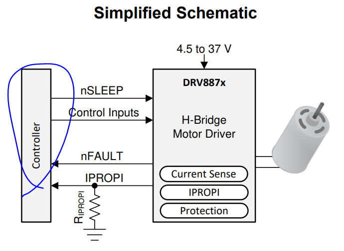

My customer has question about PH/EN mode of DRV8874.
Customer wants to rotate DC motor in forward direction using PH/EN mode.
First, he sets nSLEEP=EN=PH=1. ← Is this setting correct?
Will PWM control still needed from controller side ? Or customer can fix Pin No1, 2 of DRV8874 to High state?
For my understanding, if customer wants to regulate motor speed, customer needs PWM control for EN pin and set PH pin to high state. Is it correct?
Thanks.
Jo
  • Hello, Jo::
    "he sets nSLEEP=EN=PH=1" correct.
    The controller side doesn't need to send the PWM control signal .The customer can fix Pin No1, 2 of DRV8874 to High state if they want the output current flowing direction always same. Datasheet "7.3.3.2 Current Regulation" section gives the detail.
    If the customer doesn't want to use DRV8874's current regulation, they can disable it or change to PWM mode to give the PWM signal. If you check the Table 3. PH/EN Control Mode logic true table, you can find PH/EN mode doesn't need PWM signal.
