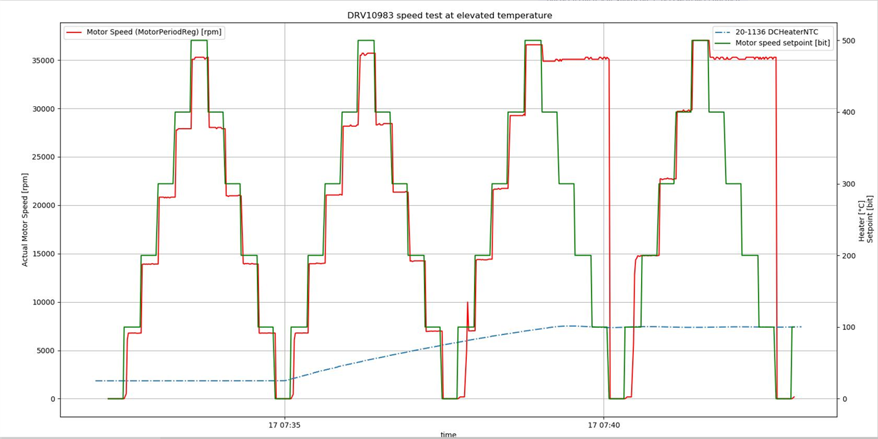

Problem:
- At some point around T > 80...90 °C the motor speed does not follow the motor set point when decreasing the set point
- Motor keeps running at some random high rpm value although set point is decreased, eventually the motor stops at a set point of 0
- The behavior is fully repeatable
- Profile of speed signal response in function of ambient temperature, first two runs are pass, third and fourth runs actual speed stays randomly high until setpoint = 0

    At high temperature, we expect to see some drift in the motor speed due to motor parameter variations. Can you read the estimated Kt at room temperature and higher temperature to see if there is any difference? If there is any difference seen, then can you adjust the lead time till the estimated Kt at higher temperature matches estimated Kt at room temperature?
    Vishnu.
