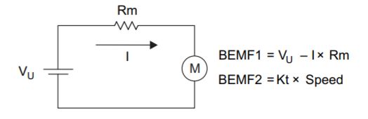

    4.In the FOC control, I know that the BEMF constant and motor phase resistance is very important ,But I don't know how they affect the work of the motor, can you explain it to me in detail?
    • In sensorless FOC or sine, we need to calculate/estimate the back-EMF because there is no zero-crossing window open to directly measure it. Trapezoidal control has these zero-crossing windows due to the waveform shape. To calculate/estimate the back-EMF, you need to do the following calculation (see the DRV10987 datasheet for how it is done on this device). Motor resistance as well as the back-EMF constant are needed to calculate the back-EMF if you know the motor current, supply voltage, and motor speed.
