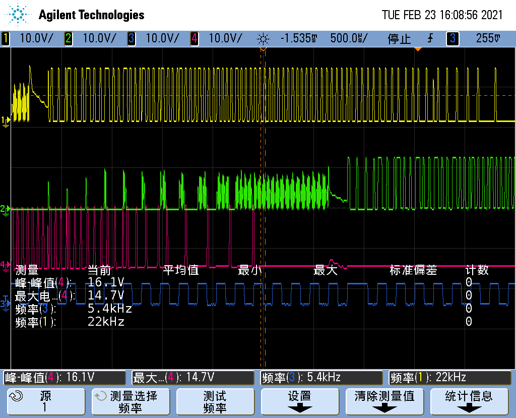

EMI test, in the low frequency band, the EMI is high,by combining the motor wire and shield with the test frequency of 22kHz,
I'm sure it's a 22 kHz frequency, which is when the TOFF is 22 kHz, how to solve the EMI problem?Thanks!

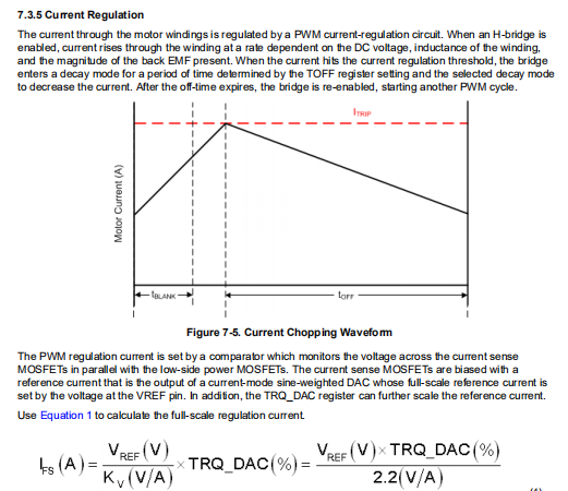

Datasheet 7.3.5CurrentRegulation Below,

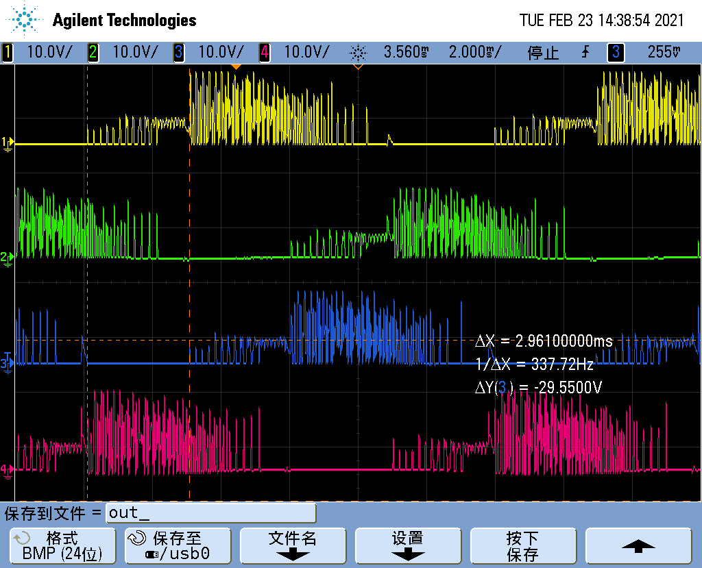

DRV8889 EMI waveform:

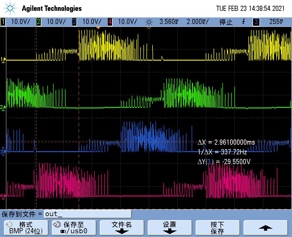

DRV8889-4coil test waveform:
Test the frequency of the first channel waveform.At about 22 KHZ;

    Assume you talk about the input side conductive EMI. Do you test is with an EVM or your own board?
    1. Add more capacitors at input;
    2. If the input has pi filter, increase the inductor value.
    3. What decay mode do you use? Can you change it to the ripple control decay mode?
