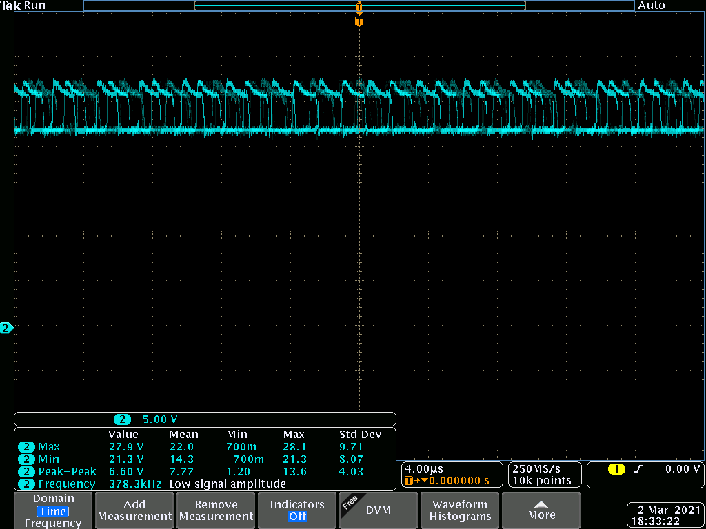

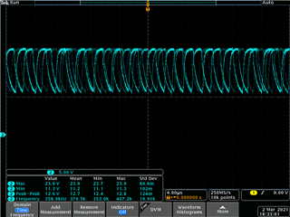

  • CPH pin of working ic
    first image shows the waveform on CPH pin of working drv8876 IC
    cpl pin of working ic
    second image shows the waveform on CPL pin of working drv8876 IC

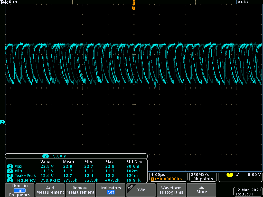

    CPH of fault ic
    third image shows the waveform on CPH pin of faulty drv8876 IC

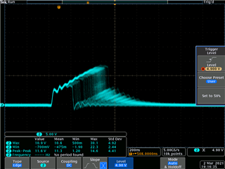

    cpl pin of faulty ic
    fourth image shows the waveform on CPL pin of faulty drv8876 IC

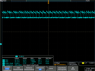

    vcp pin of faulty ic
    fifth image shows the waveform on VCP pin of faulty drv8876 IC
  • Hi Sharon,
    Thank you for providing the information.
    The VCP of the faulty device is lower than the expected typical value. So the charge pump is definitely not operating properly.  I can't really think of an explanation for it at the moment. Please give me one business day to research.
    Do you think you can share your driver schematic? I want to take a look at the charge pump components. You can share it via private message if you don't want to share in the forum.
    How are you providing power to the driver? are you using a switch or is it directly connected to a bench power supply? I have observed some issues occurring in the charge pump (leakage current and high temperatures) when very large VM slew rates are applied to the device. Normally, bulk capacitors near the power entry point of the board will help minimize the VM slew rate. Our devices have a maximum slew rate for safe operation.
