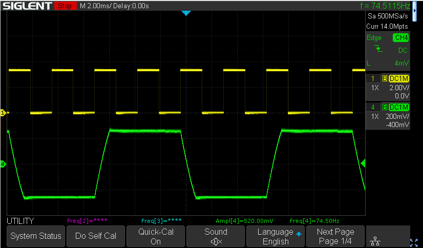

    For reproducing the mentioned issue we ran a bench setup using the EVM under maximum phase current conditions mentioned in your post, 2.5A (VREF = 3.3V), VM = 24V, Full-step mode, 300PPS, and ambient temperature was 23degC with a 3A maximum current rated stepper motor. The decay mode was at the default setting, Smart Tune Dynamic Decay, TOFF = 24us. The EVM was flipped vertical to allow free-air conditions to the bottom of the EVM. We tested the setup under the full load condition for longer than 1.5 hours with no incidences of OTSD, over temperature shutdown. We are unable to reproduce the described issue. Please see attached oscilloscope screen capture. Yellow trace is step input and green trace is one winding phase current with 1mV = 10mA current probe.
    We suspect heat was not effectively removed from the driver during your test. With proper PCB thermal design we expect 1.7A RMS (for square waves as in full-step, Vrms = Vpeak) phase current setting should be comfortably driven with proper PCB thermal design suitable for the specific use case. This document https://www.ti.com/lit/an/spra953c/spra953c.pdf is a great reference read for understanding IC Package Thermal Metrics.
