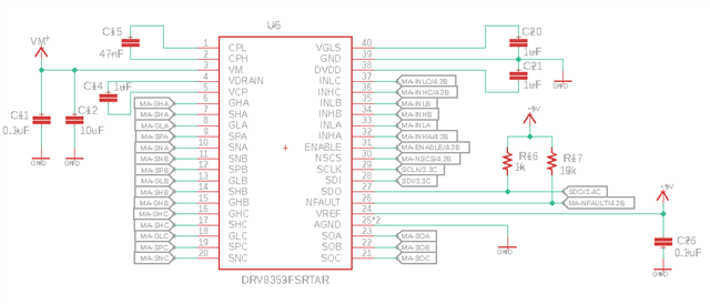

Figure 9-1 of the DRV8353 datasheet shows a direct connection between VM and VDRAIN. This connection is not indicated on figure 8-1 through 8.8. It is also not shown of the schematic for the DRV8353 EVM. Is the connection shown on 9-1 correct?
