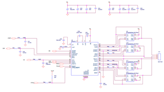

We have a stepper motor driver board that uses the DRV8711. We have produced several hundred of these boards without issue. The design uses a 50 milliohm sense resistor. Until recently, we have been using a Stackpole CSM2512FT50L0 for the sense resistor. It was recently changed to a Yageo PA2512FKE7W0R05E due to stocking issues. Both resistors are 50 milliohm 1% in a EIA-2512 package. The new resistor (Yageo) is rated for 2W while the old resistor was rated for 3W.
The stepper motor current is 2.8A and the power supply voltage is 36V. The power dissipation is (2.8)^2 * (0.05) = 392mW so either resistor should be fine.
We have found that boards built with the Yageo current sense resistor cause the attached stepper motor to whine and screech noticeably compared to the Stackpole resistors.
The PWM waveform on the stepper coil for boards built with the original resistors shows a clean 59kHz square wave. The same measurement on the boards with the new resistor shows a lot more jitter on the waveform. Both measurements were taken with the motors idle.
I have attached a copy of the schematic and some oscilloscope screen captures:
StackpoleChopperSignal.png - Stepper motor winding voltage using the original sense resistors. Clean, 60kHz square wave.
YageoChopperSignalPersist.png - Stepper motor winding voltage with the new sense resistor. Unstable duty cycle captured with scope display on persist.
YageoChopperSignalPersist.png - Stepper motor winding voltage with the new sensor resistor. Unstable duty cycle captured in single-shot mode showing runt pulses.
The DRV8711 settings are listed below:

  • Hi James,
    I suspect new resistor has higher parasitic inductance and switching noise is disturbing current regulation.
    Try to place small mlcc caps 100pF - 1nF X7R or X5R across ISENN and ISENP pins close to DRV8711.
    Do you use differential pairs for routing signal from sense resistors to ISEN pins of DRV8711?
    If fix with these caps does not work it would be necessary probably to look into PCB layout, settings and other waveforms.
    Grzegorz
  • Hi James,
    Have you observed this behavior in more than one board?. Can you try testing with various resistors of the same value and tolerance %. Do you see any major differences in the output waveform or the noise/vibration levels of the motor?
    I agree with Grzegorz theory. Increasing the resistor parasitic inductance can affect the current regulation specially if the motor has low winding inductance.
