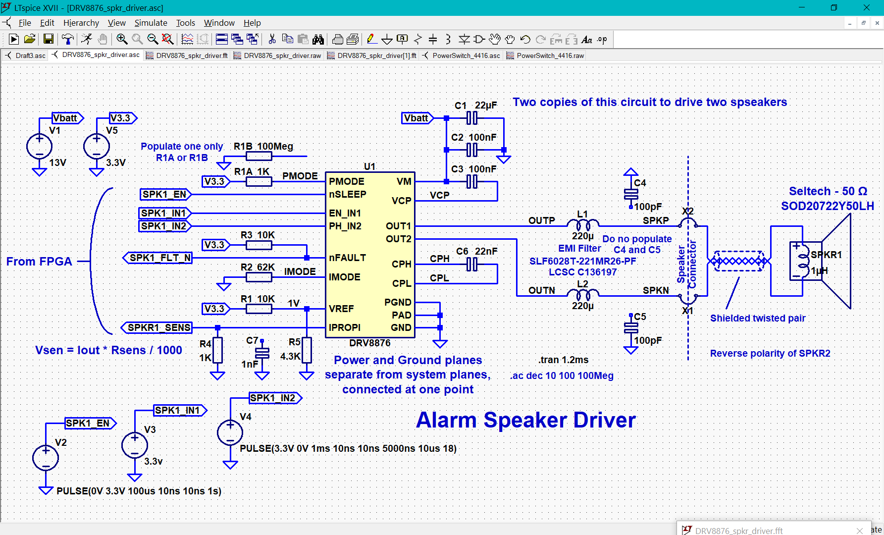

I'm simulating the DRV8876 in PWM mode with IN1 held high and IN2 toggling and no current limiting.  I'd like to use a variable PWM pulse width from near zero to near 100%.  The data sheet reports a tpd time of 650 ns typ and a rise/fall time of 150 ns.  So no indication of an asymmetry in input to output delay.  Yet the simulation shows an 800 ns high pulse on IN2 being narrowed to less than 300 nS on OUT1.  The fall time is very short and the rise time is on the order of 50 ns, so not the cause of the issue.  The rising edge of IN2 is delayed 680 ns while the falling edge is delayed less than 200 ns, so nearly 500 ns of asymmetry.
If the pulse is inverted being low for 800 ns, I see a 740 ns delay on the falling edge of IN2 and only 130 ns delay on the rising edge of IN2 giving a high pulse on OUT1 of just 200 ns.
When the input PWM is more even I see a much more even delay in tpd around 700 ns.  At a 1/4 duty cycle the tpd is asymmetrical but not as bad as the very low or very high duty cycle.  It's as if the duty cycle determines the distortion in the pulse width.
Is this expected?  Is that as good as the actual chip will perform?
I was hoping to simulate the impact of the current draw from the power distribution, but it seems this is not modeled.  Are there any plans to add this?

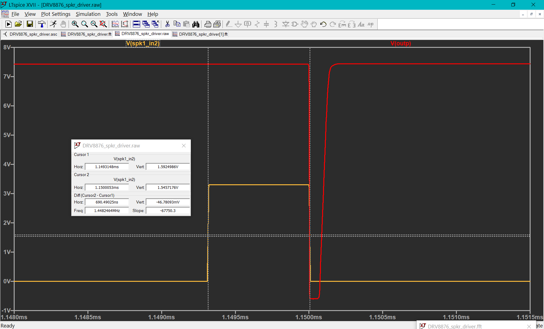

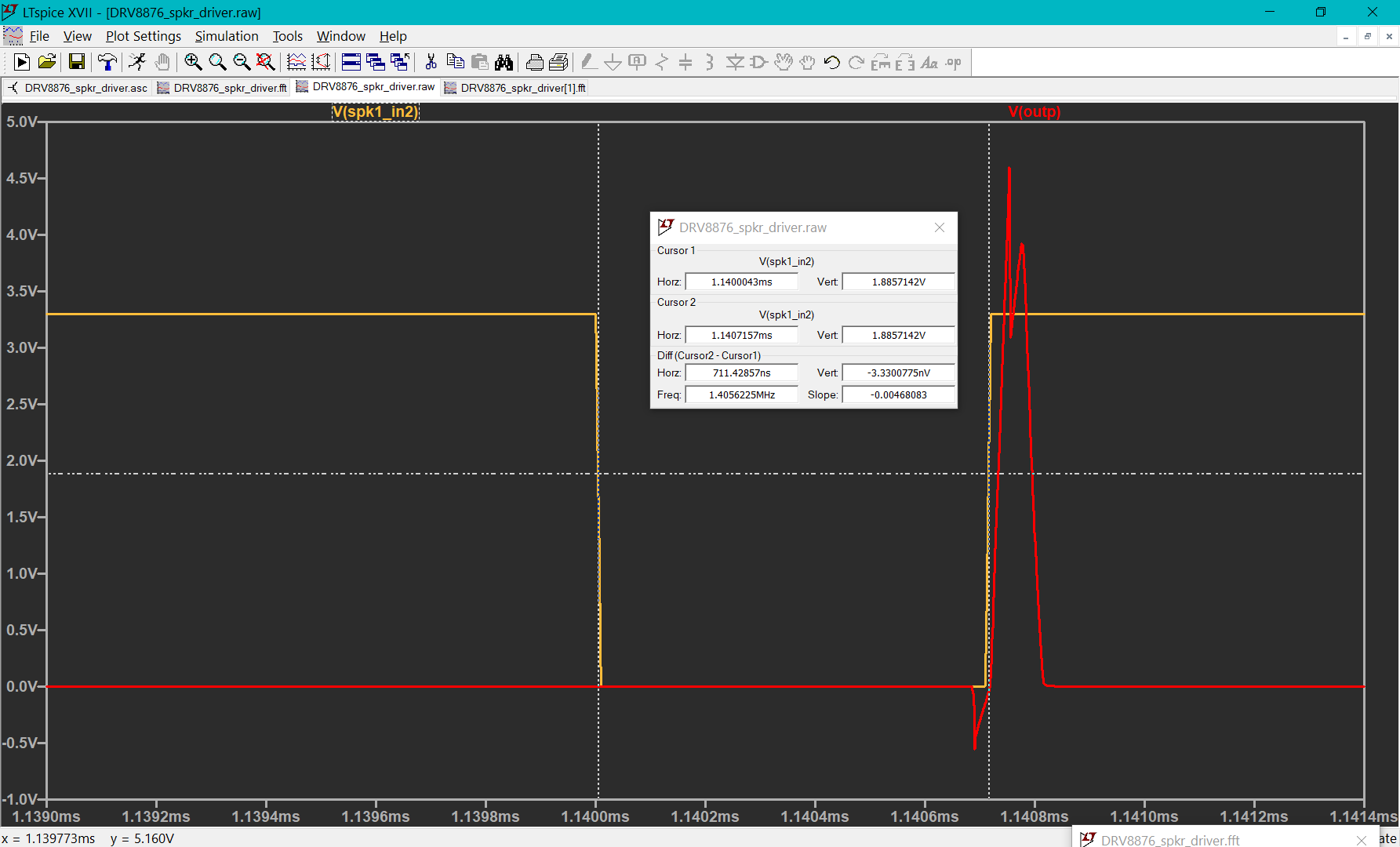

  • Hello Rick,
    If possible can you provide the waveform showing IN2 and OUT1.
    Can you provide waveform?
    It is expected behavior because of the way you are controlling the outputs. You keep IN1 held high and toggle IN2. If you look at the PWM control logic table (shown below), the h-bridge will be switching between the Forward and Brake phases. So OUT1 will be high for the amount of time that IN2 Is low. The longer that IN2 is low, the longer OUT1 is high.

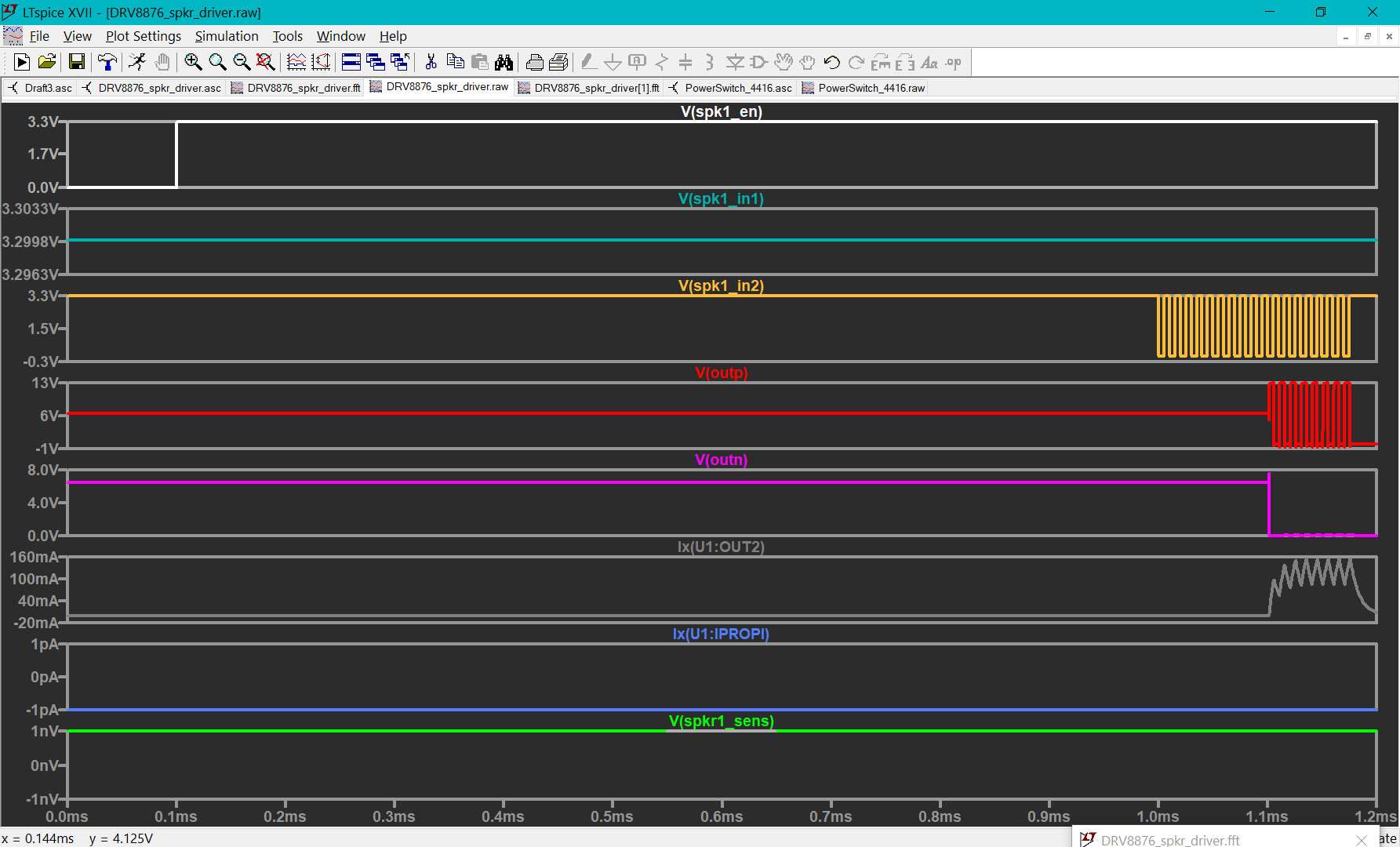

  • I think the question is not understood.  The pulse on IN2 is 800 ns wide and the pulse on OUT1 is 200 ns or less.  As the pulse is wider this distortion becomes less.  As the pulse is more narrow the distortion become greater making the pulse on OUT1 disappear.  This happens on both positive and negative pulses.
  • Here are images of the pulses, one with IN2 high for 700 ns and the other low for 700 ns.  The outputs are barely pulses.  The high going OUT1 pulse never makes it up to the 7.5V power supply voltage. Then one on a 50/50 duty cycle showing a nearly perfect 50/50 square wave on OUT1 to within 43 ns.
     Even tpd, no distortion

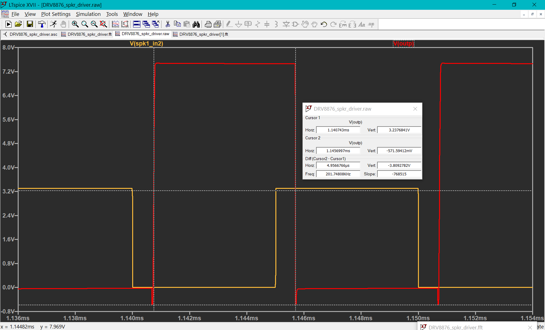

  • Hi Rick,
    I think the issue here is that you are providing a very high PWM frequency. The DRV8876 has accept a maximum PWM frequency of 100kHz. With your current set-up, the frequency is 714286kHz which is very high for this device. Can you try to decrease the frequency and try again?

  • I'm not sure how you are measuring the frequency, but it is exactly 100 kHz.  Perhaps you are measuring the pulse width rather than the period.  In the two narrow pulse examples you can not see the full period, but it is the same as the 50/50 duty cycle example which you can clearly see has a period of 10 us so 100 kHz.

  • Rick,
    I misunderstood your following statement. I thought the period was 1400ns (700ns + 700ns). Sorry about the confusion there. Looking at the waveform I can see that the frequency is 100kHz.

    TEXT -520 224 Right 3 ;To FPGA
    TEXT 928 -216 Center 3 ;Two copies of this circuit to drive two spseakers
    TEXT 896 632 Center 5 ;Alarm Speaker Driver
    TEXT 616 392 Left 2 !.tran 1.5ms
    TEXT 552 440 Left 2 ;.ac dec 10 100 100Meg
    TEXT 1080 328 Left 2 ;Shielded twisted pair
    TEXT 1080 416 Left 2 ;Reverse polarity of SPKR2
    TEXT 384 520 Center 3 ;Use local power and ground planes\nseparate from system planes,\nconnected at one point
    TEXT 896 112 Center 2 ;Do not populate\nC4 and C5
    TEXT 760 184 Center 2 ;SLF6028T-221MR26-PF\nLCSC C136197
    TEXT -40 568 Center 2 ;Do not populate C7
    LINE Normal 1024 432 1024 -80 1
    LINE Normal 1207 160 1096 160 1
    LINE Normal 1152 224 1120 304
    LINE Normal 1207 208 1096 208 1
    LINE Normal -480 224 -512 224
    CIRCLE Normal 1104 208 1088 160 1
    CIRCLE Normal 1216 208 1200 160 1
    ARC Normal -480 432 -336 16 -408 49 -410 400

  • The original issue was never resolved.  We determined that I am running at 100 kHz which is an appropriate frequency.  When IN1 is held high and vary the duty cycle of IN2, the pulse width of OUT1 tracks the pulse width of IN2 until the duty cycle approaches either 0% or 100%.  As the IN2 pulse width increases, at about 93% the output pulse on OUT1 becomes 100% low.  Likewise as the pulse width on IN2 reduces at about 7% the OUT1 low pulse width drops to 0%. This makes a significant portion of the range of outputs very hard to use.
    Is this another problem with the simulator?  Or is this an accurate representation of the chip?
  • Hi Rick,
    I think the issue here is caused by the high PWM frequency. There is a minimum pulse time of around 600ns typical (t_rise+t_fall+t_dead) for this device. At 93% Duty cycle, the TOFF is around 700ns which is close to the 600ns minimum pulse that the device allows. So that's why OUT1 remains high despite the input control signal going LOW for a very short period of time. Likewise, when the duty cycle is 7%, the TON is 700ns which is too fast for the driver to process and will result in 0V at OUT1.
    This is expected behavior for the chip and model.
  • Ok, so this is a limitation of the chip, not just a simulation artifact.  It's not so much a matter of frequency, but an issue of a minimum pulse width.  It would be useful if this were clearly stated in the data sheet.  While you have explained it with by adding the three parameters that are provided, it is not obvious that the chip works this way and that the value is 600 ns.
  • I've had a chance to think about this some more and I don't think the issue I am seeing is explained by the dead time and the rise/fall times.  The pulse width is not shortened by both the rise and the fall time.  One puts a slight delay in the leading edge and the other adds a slight delay to the falling edge.  So both edges would be delayed a small amount having no affect on the pulse width.  Likewise, the dead time delays each edge which again simply delays the pulse rather than shrinking it.
    The dead time shows up as the output being pulled below ground by the inductance of the load forcing the body diodes to conduct.  So the output pin drops about 400 mV below ground.  In the simulation this is for a very short duration.  However it is delayed from the falling edge of the IN2 pulse by 700 ns but only 300 ns from the rising edge when the low time is 1 us.  This shortens the output pulse on OUT1 to 500 ns.
    Then when the IN2 high time is short, it is the rising edge of the IN2 pulse that is delayed 700 ns to OUT1 and the falling edge of the IN2 pulse that is delayed by 300 ns with an IN2 pulse high time of 1 us or less.
    The dead time alone would not cause this issue.  So I am still in the dark about whether this is a simulator problem or a chip problem.

  • I'm sorry, but this doesn't make much sense to me. What you are calling dead time is not what dead time is.  Dead time is a wait after turning off one transistor in a half bridge to turning on the other transistor so the two are not on at the same time which results in shoot through current.  Dead time does not relate one pulse edge to another.  Dead time delays BOTH edges and so should not distort the pulse width.  Is there some reason why the dead time is larger or smaller for one edge than the other?
    When the pulse is wider than about 1.5 us there is no distortion of the pulse width.  If dead time were involved it would distort the pulse by the same 600 ns in all cases.  I would also point out that the typical value for dead time in the data sheet is 300 ns, not 600 ns.
    Here is an illustration of what I'm seeing.  The dead time is less than 100 ns as indicated by the voltage on OUT1 going below ground due to the body diodes conducting while neither FET is turned on.  The cause of the narrowing of the output pulse is a difference in delay on the two edges of the pulse as the pulse narrows.  Whatever is causing this is altered by the time from the previous edge.  As the pulse width widens, the difference in delays of the two edges vanishes.
