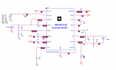

  • I think I figured out a problem with the IPROPI current.  For some reason the current out of the VREF pin matches the current on the IPROPI pin exactly.  If the voltage on VREF is set by a resistor divider this current changes the voltage on the VREF pin.

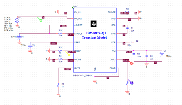

    I've been looking at the model in more detail and it seems that the IPROPI is not working properly. However, I did find a way to get it working. The schematic below has been been working for me (I have a DRV8874-Q1 on this schematic but has same behavior as the DRV8876). To get it to work, you have to place the load in both OUT1 and OUT2, as shown below, rather than connecting the load between OUT1 and OUT2. So you have to duplicate the load in both OUT1 and OUT2. The other characteristics of the model should be the same with this configuration. I suggest testing with a simple resistive load first to check functionality and then placed your desired load.
    I hope this works for your validation purposes. If you need further testing, you can get an EVM.
  • I see the voltage on Vref is about 0.25V which is not correct.  It should be 1V.  Instead it seems to track IPROPI.  This prevents the current limit from being tested.
    Is TI planning to fix this model?
  • Hi Rick,
    Thank you for pointing this out. I totally missed this when I was doing the simulation. i did further testing and I think the issue is using a resistor network to set VREF. When I set Vref using a DC supply, the measurement on IPROPI seems to be correct as shown in the schematic below. Can you try this in your simulation?
