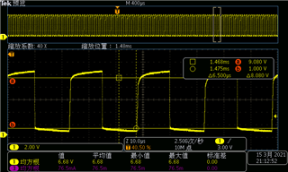

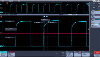

I have tested the DRV8323RS   MOS GS Drive signal ,but i found that it is not a perfect square wave,
I have set the IDRIVEP_HS =80mA, IDRIVEN_HS =1640mA, if i set the IDRIVEP_HS more high, the GS waform will be oscillated;
so i have some doubts
1:what caused the waveform not the square wave ?
2:when VGS is set to low, why the Vgs valve is not till to zer ?
 plz check the following pic ,this is the low-side Mos Vgs waveform;
2: the following pic is the high-side mos drive waveform,
1: why the Vgs max voltage vibrate  ? the vol ranges 10.6~11V ,which is not fixed
high-side Mos Vgs
pls help me ,thanks
  • Hello, and thank you for your question.
    1. The gate waveform is not an exact square wave since you are driving current into the MOSFET gate (which is like a capacitor). This current causes the voltage at the gate to increase over time. It cannot be a perfect square wave, there will be some rise time.
    2. Can you confirm how you are measuring the low-side gate waveform? The low-side gate pulls down to the PGND pin. If there is some difference between PGND of DRV8323R and the MOSFET GND then you could measure some offset on the oscilloscope. It sounds like there is no issue during operation (the low-side MOSFET stays OFF) so I think this may be a measurement error.
    3. The high-side gate drive voltage is generated by a charge pump, and this charge pump has a certain transient current capability. When you have a high IDRIVE or drive multiple high-side MOSFETs simultaneously, the charge pump voltage will drop some. The charge pump will then work to increase the VCP voltage over time. This can result in some ripple observed on VCP which will also be seen on the high-side gates. There should be no issue during operation even if this ripple is seen.
    Matt

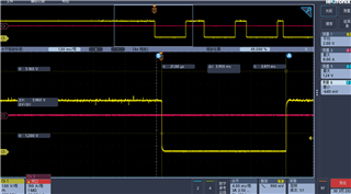

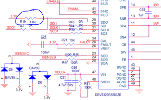

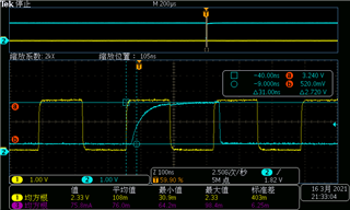

    I still have some question about SPI waveform doubts
    #1:why SDO signal rise some slow ?  i have changed the pull-up resistor R19 to 1K ;  check the following pic
    #2: why the SDO Low voltage is not zero? ,check the pic as above, i have checked my probe, it's no question;
    #3: about  tD-SDO time , It has exceed the time 30ns , how to solve the question;check the pic as above;
    plz  help me
    thankyou
    Is there significant capacitance on the SDO line on the PCB? Have you added capacitance to the trace or is the trace very long on the board (parasitic capacitance)? If you try to remove R42 is the rise time reduced?
    Where are you placing your ground for the oscilloscope probe?
    The tD-SDO specification is the delay time internally to the DRV8323R. After a maximum of 30 ns from a clock edge, the SDO output will change.
    Matt
  • thanks
    1: no any capacitance to the trace , the trace length si  720mils , i think it is not long;
        R42 is just 0Ω, i don;t think it will affact the time ;
    2: I  have place the ground near the DRV8323, so i want to know  the correct  connecting ground place ?
    3:tD_SDO is fixed time ,we can't change  ,right ?
    thanks
    1. The recommendation to remove R42 is to see if disconnecting the SDO pin from the rest of the circuit has any effect on the rise time that you can observe. This would isolate the SDO pin.
    2. The best GND location would be AGND pin 35. However if there is a strong ground connection it should not matter. Is there any issue in SPI communication happening?
    3. tD_SDO is fixed internally to the DRV8323R
    Matt
  • hi  matt
    1: i have delete the R42,  the SDO waveform still rise slowly ,check the following
    2: till now   we did not find some issue  of  SPI communication , if that , do we need to focus the point ?
        because the reception is MCU , It meets  MCU SPI timing
    thanks
    Since the SPI communication is functioning properly, I do not think there is an issue. If SPI communication issues were occuring, we could slow down the SPI clock, but I don't think it is necessary.
    Matt

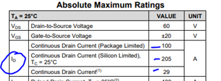

    #3: i check the MOS datasheet , ID has three specs , how to explain IT?

    3. The MOSFET will be current limited due to the construction of the package, the die itself, and thermal properties.
    • In the 1st spec this is how much current the package is designed to handle (i.e. bondwires).
    • The 2nd spec, this is how much current the die is designed to handle (i.e. die metallization).
    • The 3rd spec is the expected current the MOSFET is capable of driving contiguously without exceeding the temperature rating. The 3rd specification is based on a board with RθJA= 40°C/W, and if you have a board with better thermal characteristics you can expect to drive higher current.

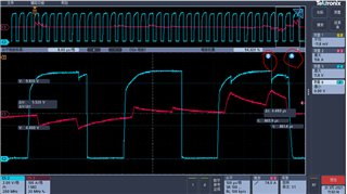

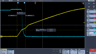

  • hi matt
    yes you're right, it is the GDF;
     I have read the register of 0x01, value:0110 0000, Fault Status1:0101 0000 0000   it means VGS_HA is high;
    the waveform  as belows, pls check the following,
    the falling duration between A and B is 4.48us,  tDRIVE is 4us, 4.48us >4us,so the GDF  occurred , is it right  ??
    why at B moment, it changes to rise ?  it should  fall   ??
    plz~~~

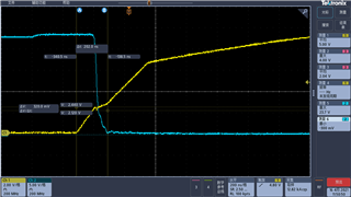

  • hi matt
    another question:  how to measure tDRIVE time ?
    now i set tDRIVE time = 4us
    but if i measure the VGS  voltage from zero to 11V , the time excess 4us,  maybe lead to the GDF,  but actually GDF did not occur ;
    check the waveform as follows
    so how to measure the tDRIVE rightly ,pls
    The GDF threshold is between 1V and 2V, and so the gate has to be higher than this voltage to register as ON. When turning ON the MOSFET the DRV832x checks that the gate is higher than the threshold after TDRIVE time, when turning OFF the DRV832x checks that the gate is below the threshold after the TDRIVE time. As long as the gate voltage gets higher than 2V, it will not cause a GDF when turning ON the MOSFET.
    It looks like the gate is forced high when it is trying to turn OFF due to the short on the motor. Since it does not shut OFF within 4us, a gate drive fault (GDF) is asserted and the device will shut down.
    It may be good to observe the GHA, SHA, and GLA on the oscilloscope just before the fault occurs.
    You may also try reducing the IDRIVE setting to see if the GDF fault goes away. We have seen some cases where the high gate drive current can cause oscillation which trips the gate drive fault.
    Matt

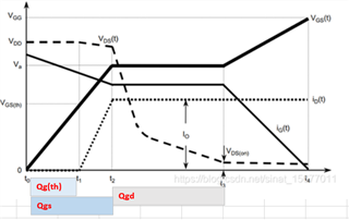

     how  to choose the appropriate value of IDRIVE ? because it is related to the  MOS rise and fall time ,when driveing MOS on-off ;
    if using a 40KHz PWM signal(period = 25us), so how much time of  MOS propagation delay should I  selected ?  ( 1% of overall period ?) or  others
    thank you
    Faster switching is better because it reduces delay and switching losses, but there is always a limit on how fast you can drive the MOSFETs. If the slew rate is too high, you can cause ringing, EMI, or voltage over stress. If a board has significant parasitic inductance, that will limit how fast you can go.
    We normally recommend between 100ns and 300ns rise time; Rise time = Qgd / IDRIVE. CSD18540Q5B has a Qgd of 6.7nC so we would recommend an IDRIVE between 22.3mA  and 67 mA. So the IDRIVEP setting should be 30mA or 60mA. The IDRIVEN can be set to 2x IDRIVEP, meaning 60mA or 120mA.

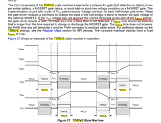

  • hi  Matt
     as the DRV8323 datasheet refer: check the following red line
    so the correct threshold voltage of VGS  above  is what ??
     i do not find in the datasheet ~~
    thankyou ~
    The gate drive fault uses a threshold of about 2V.
    • If the gate is measured below 2V after trying to turn ON, it is considered a fault.
    • If the gate is measured above 2V after trying to turn OFF, it is considered a fault.
    Matt

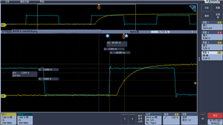

  • hi matt
     still had some questions about MOS-GS-signal,check as follows;
    -#1: when set the IDRIVEP = 60mA,  the high-side MOS  VGS-signal(GHx )  will oscillate in heavy load, which caused SHx signal oscillate ;
    but in light load , it has no oscillation;  check the following waveform,  (I measured  low-side MOS Vds as SHx signal )
    - then  I tested hig-side MOS  VDS  signal , finding no oscillation,so why?
    i think if high-side MOS Vds has no oscillation, it has no question , is that right ??
    #2:  when set the IDRIVEP = 30mA,  the high-MOS  VGS-signal (GHx ) has no oscillation , no matter under heavy load or light load;
    so how to set the value of IDRIVEP ? 30mA  or  60mA ?
    if  setting IDRIVEP = 30mA, the  rise time turns longer (rise time about 390ns), is that appropriate ? now i have set Tdrive=500ns
    (you can check the waveform above , previously i have  discussed the IDRIVEP value  with you )
    plz~~
  • Hello again!
    Under high current it does look like a small oscillation is introduced on the gate and phase waveform. This is normal because at higher currents the effect of the PCB trace inductance will be more. The oscillation is not very significant, and it does not exceed the voltage rating of the device.
    I would recommend keeping with the 60mA setting for now in order to have lower switching loss. If you run into EMI problems later, you can decide if you need to further reduce the IDRIVE. I do recommend increasing TDRIVE to 1us for your 60mA setting and if you decrease IDRIVE to 30mA I would use 2us TDRIVE.
    There are other ways to mitigate the oscillation on the board, for example adding snubbers to the output (like in this article: LINK).
    Matt

    look at the belowing pic, how to measure the Charge time of GHx ?
    from A to B  or from A to C ??  in my opinion  ,Charge time of GHx is from A to B , is that right ?
     thankyou
  • Yes, that is a very good question.
    In your plot, the time from A to C is TDRIVE, and you can see that the MOSFET gate starts to charge more slowly after TDRIVE is done because the gate drive current switches from IDRIVE to IHOLD (the slope of the yellow trace changes at C). Ideally, you want to completely charge the gate before TDRIVE is done. So I can tell that TDRIVE is set too low.
    The total charge time for the *gate* is from A to after C, because the gate is still increasing in voltage after C.
    The charge time from A to B is the most important for the motor operation, because this is where the output (SHx) will switch including the miller region.
    Matt

    but "choose an IDRIVE such that QGD / IDRIVEP is in the range of 100ns to 300ns."
    why use the formula QGD / IDRIVEP,  rather than (Qgs-Qgsth+Qgd)/ IDRIVEP   or  (Qgs+Qgd)/ IDRIVEP
    becasue actually the MOS switch on time is  from t1 to t3, so what do you think of that ?
    and also the falling time tf= QGD / IDRIVEN  rather than (Qg-Qgth)/ IDRIVEN
    maybe I do not understand it fully
    pls help ~
    QGD (miller plateau) is the most important factor in the voltage slew rate at the motor terminals, so QGD / IDRIVE  = 100 to 300ns is the guidance for the target rise and fall time on the output. This is the rise or fall time at SHx, not at GHx or GLx. In your diagram, the MOSFET VDS is switching between t2 and t3. t0 to t1 is a delay before the MOSFET begins to turn ON, and the current begins to flow in the MOSFET between t1 and t2. We do not count t1 to t2 to calculate the slew rate because the output voltage does not change during this time, even though the current is changing.
    The MOSFET gate rise time is not as important for the system. This would be the time it takes for the GHx or GLx to rise from 0V to 11V (through QGTOTAL). We recommend making sure that TDRIVE is set to be greater than this time.
    Matt
