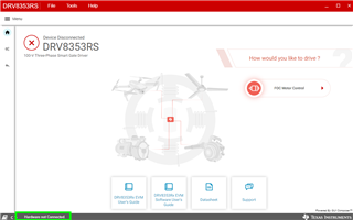

I just received a DRV8353RS-EVM and it will not connect to my PC.  I installed the DRV8353Rx 1.0.1 GUI and followed the instructions.  Initially it says "hardware not connected" and then reads (bottom left) "TICloudAgent.Init Error" after I choose the correct DRV chip.  I also installed the ticloudagent_2 and I don't really know much about that but it does not appear to connect after attempting.   I read a similar thread but the resolution was never disclosed, TI only told the user to email the them.  I have added some images as was requested on the previous thread.  Please let me know how I can trouble shoot this issue.

  • Thank you for the quick response.  I uninstalled the older verson (7.4.1) of gcruntime and installed 8.0.0 as you recommended.  Unfortunately, I still cannot connect to the DRV8353RS-EVM.  Is there something else I can try?
  • Hello Mike,
    Alright, looks like we need to walk through all the typical debug steps to see where in the chain we're failing, hopefully it doesn't end at your computer or else i'll need to loop in another team.
    ISO Hardware:
    Looks like the serial switch is OFF and all 3 switches are in the ON position for the Boot switches, as expected. Looks like we have the LEDs for 3V3 and GPIOs so we're getting power. The USB is connected as expected and everything looks right. So I can only assume these are right, for now.
    Recognizing the device
    While the GUI is open, if you open the Device Manager on your computer, look at the Ports, unplug the EVM, look at the Ports, plug it back in, and look at the ports one final time, can you be certain that ISO is recognized by the computer? If so, we need to move on the GUI specifically.

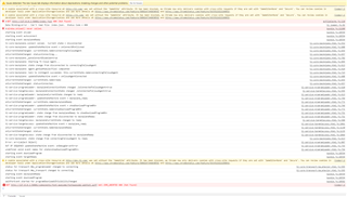

    Can you get the logs when trying to connect? By pressing F12 and navigating to the Console tab, you should have a log of what is happening as the GUI is starting up or after you try to connect again. This might give us a clue more than the error message shown on the bottom left. At this point in the debug I'll have to pull in another team to see what we can do as there's nothing on the HW side that seems to be the issue.

  • Hi Cole,
    The device is being recognized when I look at the PORTs and the log is shown below after I try to connect by selecting the proper DRV8353Rx (DRV8353RS).  I verified a couple items in the TICloudAgent troubleshooting guide but I'm not clear on how to determine everything.

  • Hi Mike,
    The source map warning is most likely not the cause of connectivity issues. Source maps are used to assist in debugging, but should not be causing functional issues. The text slightly above (MISSING EXTENSION) is most likely the message that is relevant. Unfortunately, I will need a bit more information to see if we can figure out what the issue is. Thus I would like for you to enable extra logging to see if we can get more detailed information.
    Once you start DRV GUI and hit F12 a new window should open up. Selecting "Console" tab should show the same log as you captured below. Near the bottom there should be a command prompt, I'd like you to enter this command "gc.console.setCookie("all",5)" and hit enter. You should get a response "Found 1 cookie". This enables extra logging. Now with dev tools window active, hit F5, this should trigger a complete reload of the GUI with more complete logging information. Once the GUI fails to connect, then please switch back to Dev tools (I.e. the window that opens when you press F12), activate Console tab (if not active) and Select All (i.e. CTRL+A), copy and then paste into a text file and save.
    Could you attach the log to this thread?

  • Hi Martin,
    Attached is the log as requested. This is after I choose the desired DRV8353 option, RS in my case.
    (index):40 window.opener = null
    (index):46 typeof process = object
    41HTML Imports is deprecated and has now been removed as of M80. See <URL> and <URL> for more details.
    customCodec_0.js:31 Uncaught TypeError: Cannot read property 'IPollingPacketCodec' of undefined

    ti-core-assets.html.js:184 Help for gc.console:
    To see logs for a particular module, set a cookie for that module name (e.g. gc.console.setCookie('ti-core-backplane',5) ).
    To see logs for all modules, use a module name of 'all (e.g. gc.console.setCookie('all',5) ).
    To see the location that logged the message, click on the triangle to the left of the message to expand the stack trace.
    Colors: Red: error, Orange: warning, Black: info or a generic log, Blue: debug.
    Commands: the following function calls can be called from the Chrome dev tools console window command line:
    gc.console.setCookie(moduleName,<0-5>)
     - creates a cookie for the specified module name. Use 'all' for all modules.
     - value: 0 = remove the cookie, 1 = only errors, 2 = errors and warnings, 3 = errors,warnings,info, 4 = errors,warnings,info,logs, 5=debug+all others
    gc.console.getCookies()
     - dynamically updates any added or removed cookies and returns a list of all currently active cookies and their values.
    gc.console.log(moduleName,msg)
    - To log messages, use gc.console.log / gc.console.error / gc.console.warning / gc.console.info / gc.console.debug
    ti-widget-vtabcontainer.html.js:358 ti-widget-vtabContainer.noInk = true
    ti-core-backplane.html.js:1456 ti-core-backplane ready function called
    ti-service-programloader.html.js:1453 ti-service-programloader.initialized set to false
    2ti-core-transport-base-behavior.html.js:595 status for transport #undefined changed to disconnected
    ti-service-programloader.html.js:1453 ti-service-programloader.initialized set to true
    ti-service-targetaccess.html.js:628 ti-service-targetaccess: backplane event handlers initialized. backplane.currentState.name=disconnected
    main.js:278 Application template has been stamped.
    ti-widget-vtabcontainer.html.js:760 ti-widget-vtabcontainer.onVtabItemsChanged called.
    ti-widget-register-model-adaptor.html.js:157 Using register model id=my_model
    ti-widget-statusbar.html.js:616 ti-widget-statusbar.updateBranding: about to read project.json
    ti-service-programloader.html.js:687 ti-service-programloader: backplane event handlers initialized. backplane.currentState.name=disconnected
    ti-service-programloader.html.js:613 ti-service-programloader: backplaneCurrentState changed to disconnected
    ti-service-programloader.html.js:746 ti-service-programloader: updateStateMachine event = backplane_disconnected
    ti-widget-statusbar.html.js:626 ti-widget-statusbar.updateBranding: _showTiLogo = true
    ti-core-backplane.html.js:1536 ti-core-backplane: project.json does not contain deviceName property.
    undefined:1 GET http://127.0.0.1:57421/undefined 404 (Not Found)
    ti-core-backplane.html.js:1669 POST http://127.0.0.1:57421/analytics 404 (Not Found)
    postData @ ti-core-backplane.html.js:1669
    (anonymous) @ ti-core-backplane.html.js:1587
    (anonymous) @ polymer.html.js:1309
    setTimeout (async)
    run @ polymer-mini.html.js:2099
    async @ polymer.html.js:1308
    attached @ ti-core-backplane.html.js:1558
    proxy.attached @ SingletonService.js:193
    (anonymous) @ polymer-micro.html.js:272
    whenReady @ polymer-micro.html.js:103
    attachedCallback @ polymer-micro.html.js:263
    attachedCallback @ polymer-mini.html.js:174
    _attached @ webcomponents-lite.js:2028
    attached @ webcomponents-lite.js:2021
    added @ webcomponents-lite.js:1985
    (anonymous) @ webcomponents-lite.js:1990
    (anonymous) @ webcomponents-lite.js:1922
    findAllElements @ webcomponents-lite.js:1938
    findAllElements @ webcomponents-lite.js:1939
    forSubtree @ webcomponents-lite.js:1921
    addedSubtree @ webcomponents-lite.js:1989
    addedNode @ webcomponents-lite.js:1978
    (anonymous) @ webcomponents-lite.js:2097
    (anonymous) @ webcomponents-lite.js:2093
    handler @ webcomponents-lite.js:2091
    childList (async)
    _finishDistribute @ polymer-mini.html.js:1848
    _readyClients @ polymer-mini.html.js:147
    _ready @ polymer-mini.html.js:132
    _readyClients @ polymer-mini.html.js:144
    _tryReady @ polymer-mini.html.js:122
    _initFeatures @ polymer.html.js:4140
    render @ polymer.html.js:5462
    attached @ polymer.html.js:5446
    _readySelf @ polymer-mini.html.js:162
    _ensureReady @ polymer.html.js:5395
    _markImportsReady @ polymer.html.js:5400
    (anonymous) @ polymer.html.js:5389
    _makeReady @ polymer-micro.html.js:111
    (anonymous) @ polymer-micro.html.js:117
    (anonymous) @ timeline.js:21
    requestAnimationFrame (async)
    window.requestAnimationFrame @ timeline.js:19
    _catchFirstRender @ polymer-micro.html.js:116
    (anonymous) @ polymer-micro.html.js:163
    checkDone @ webcomponents-lite.js:1212
    loadedImport @ webcomponents-lite.js:1223
    parseImport @ webcomponents-lite.js:1577
    parseLink @ webcomponents-lite.js:1600
    parse @ webcomponents-lite.js:1538
    parseNext @ webcomponents-lite.js:1527
    parseImport @ webcomponents-lite.js:1596
    done @ webcomponents-lite.js:1637
    load (async)
    watchImportsLoad @ webcomponents-lite.js:1237
    (anonymous) @ webcomponents-lite.js:1183
    whenDocumentReady @ webcomponents-lite.js:1201
    whenReady @ webcomponents-lite.js:1182
    (anonymous) @ polymer-micro.html.js:162
    ti-widget-bitfield-viewer.html.js:539 Bitfield [object Object], attr=offIcon not found!
    ti-widget-bitfield-viewer.html.js:539 Bitfield [object Object], attr=onIcon not found!
    (index):1 A cookie associated with a cross-site resource at http://ti.com/ was set without the `SameSite` attribute. It has been blocked, as Chrome now only delivers cookies with cross-site requests if they are set with `SameSite=None` and `Secure`. You can review cookies in developer tools under Application>Storage>Cookies and see more details at https://www.chromestatus.com/feature/5088147346030592 and https://www.chromestatus.com/feature/5633521622188032.
    (index):1 A cookie associated with a cross-site resource at https://ti.com/ was set without the `SameSite` attribute. It has been blocked, as Chrome now only delivers cookies with cross-site requests if they are set with `SameSite=None` and `Secure`. You can review cookies in developer tools under Application>Storage>Cookies and see more details at https://www.chromestatus.com/feature/5088147346030592 and https://www.chromestatus.com/feature/5633521622188032.
    gcFileCache.js:110 GET http://127.0.0.1:57421/index.json 404 (Not Found)
    (anonymous) @ gcFileCache.js:110
    promise @ q.js:642
    loadFile @ gcFileCache.js:78
    gc.fileCache.readJsonFile @ gcFileCache.js:120
    gc.databind.BindingRegistry.loadBindingsFromFile @ bundle.js:7685
    (anonymous) @ ti-core-databind.html.js:13
    _fulfilled @ q.js:794
    (anonymous) @ q.js:823
    Promise.promise.promiseDispatch @ q.js:756
    (anonymous) @ q.js:516
    flush @ q.js:110
    processTicksAndRejections @ internal/process/task_queues.js:75
    ti_logger.js:82 Data Binding:error - Can't read file: index.json.  Status Code = 404
    bundle.js:11208 window.onload() never called.
    (anonymous) @ bundle.js:11208
    setTimeout (async)
    (anonymous) @ bundle.js:11204
    promise @ q.js:642
    (anonymous) @ bundle.js:11201
    apply @ q.js:1107
    Promise.promise.promiseDispatch @ q.js:748
    (anonymous) @ q.js:1333
    flush @ q.js:110
    bundle.js:10354 starting event onLoad
    (index):1 A cookie associated with a cross-site resource at http://dev.ti.com/ was set without the `SameSite` attribute. It has been blocked, as Chrome now only delivers cookies with cross-site requests if they are set with `SameSite=None` and `Secure`. You can review cookies in developer tools under Application>Storage>Cookies and see more details at https://www.chromestatus.com/feature/5088147346030592 and https://www.chromestatus.com/feature/5633521622188032.
    bundle.js:10354 starting event autoconnect
    bundle.js:10354 starting event backplaneReady
    ti-core-backplane.html.js:552 ti-core-backplane.connect called.  Current state = disconnected
    ti-core-backplane.html.js:608 ti-core-backplane: updateStateMachine event = onConnectBtnClicked
    ti-core-backplane.html.js:655 onCurrentStateChanged: currentState.name=connectingToCloudAgent
    ti-core-backplane.html.js:657 onCurrentStateChanged: status=Connecting...
    ti-core-backplane.html.js:702 ti-core-backplane._autoConnectDisabled=true
    ti-core-backplane.html.js:895 ti-core-backplane: Starting TI Cloud Agent...
    ti-core-backplane.html.js:613 ti-core-backplane: state change from disconnected to connectingToCloudAgent
    ti-core-backplane.html.js:608 ti-core-backplane: updateStateMachine event = onError
    ti-core-backplane.html.js:655 onCurrentStateChanged: currentState.name=error
    ti-core-backplane.html.js:657 onCurrentStateChanged: status=Backplane Error
    ti-core-backplane.html.js:608 ti-core-backplane: updateStateMachine event = gotoNextState
    ti-core-backplane.html.js:655 onCurrentStateChanged: currentState.name=disconnect
    ti-core-backplane.html.js:657 onCurrentStateChanged: status=Disconnect
    ti-core-backplane.html.js:608 ti-core-backplane: updateStateMachine event = disconnectComplete
    ti-core-backplane.html.js:655 onCurrentStateChanged: currentState.name=disconnected
    ti-core-backplane.html.js:657 onCurrentStateChanged: status=Disconnected.
    ti-service-programloader.html.js:620 ti-service-programloader: backplaneConnectionState changed .isConnectedToCloudAgent=false
    ti-service-targetaccess.html.js:595 ti-service-targetaccess: backplaneConnectionState changed .isConnectedToCloudAgent=false
    ti-service-targetaccess.html.js:588 ti-service-targetaccess: backplaneCurrentState changed to disconnected
    ti-service-targetaccess.html.js:1061 ti-service-targetaccess: updateStateMachine event = backplane_disconnected
    ti-core-backplane.html.js:613 ti-core-backplane: state change from disconnect to disconnected
    ti-core-backplane.html.js:613 ti-core-backplane: state change from error to disconnect
    ti-core-backplane.html.js:613 ti-core-backplane: state change from connectingToCloudAgent to error
    ti-core-backplane.html.js:963 Failed to init agent:  Error = MISSING_EXTENTSION
    ti-core-backplane.html.js:718 ti-core-backplane: "Call to initAgent returned an error."
    ti-core-backplane.html.js:608 ti-core-backplane: updateStateMachine event = onFailedToConnect
    ti-core-backplane.html.js:655 onCurrentStateChanged: currentState.name=failedToConnect
    ti-core-backplane.html.js:657 onCurrentStateChanged: status=Timeout waiting for connection to debug agent:
    ti-core-backplane.html.js:617 OUT OF SEQUENCE updateStateMachine event: disconnect
    ti-core-backplane.html.js:618 undefined valid event names for state=failedToConnect:
    ti-service-programloader.html.js:613 ti-service-programloader: backplaneCurrentState changed to failedToConnect
    ti-service-programloader.html.js:755 OUT OF SEQUENCE updateStateMachine event: backplane_failedToConnect
    ti-service-programloader.html.js:756 undefined valid event names for state=disconnected:
    ti-service-targetaccess.html.js:588 ti-service-targetaccess: backplaneCurrentState changed to failedToConnect
    ti-service-targetaccess.html.js:1070 OUT OF SEQUENCE updateStateMachine event: backplane_failedToConnect
    ti-service-targetaccess.html.js:1071 undefined valid event names for state=disconnected:
    ti-core-backplane.html.js:613 ti-core-backplane: state change from disconnected to failedToConnect
    bundle.js:10354 starting event downloadProgram
    bundle.js:10354 starting event targetReady
    ti-core-transport-base-behavior.html.js:595 status for transport #my_programloader changed to connecting
    ti-core-transport-base-behavior.html.js:595 status for transport #my_transport changed to connecting
    (index):1 GET http://127.0.0.1:57421/components/font-awesome/fontawesome-webfont.woff net::ERR_ABORTED 404 (Not Found)
    bundle.js:10582 waitForEvent started for programDownloadUIVisibilityChanged
    (index):1 GET http://127.0.0.1:57421/components/font-awesome/fontawesome-webfont.ttf net::ERR_ABORTED 404 (Not Found)
    :54870/index.json:1 Failed to load resource: the server responded with a status of 404 (Not Found)
    ti-core-backplane.html.js:924 ti-core-backplane: agent.getSubModule(File) completed
    ti-core-backplane.html.js:723 ti-core-backplane: Call to initAgent succeeded. this.currentState.name=connectingToCloudAgent
    ti-core-backplane.html.js:608 ti-core-backplane: updateStateMachine event = onCloudAgentConnected
    ti-core-backplane.html.js:655 onCurrentStateChanged: currentState.name=ready
    ti-core-backplane.html.js:657 onCurrentStateChanged: status=Connected.
    ti-service-programloader.html.js:620 ti-service-programloader: backplaneConnectionState changed .isConnectedToCloudAgent=true
    ti-service-targetaccess.html.js:595 ti-service-targetaccess: backplaneConnectionState changed .isConnectedToCloudAgent=true
    ti-service-programloader.html.js:613 ti-service-programloader: backplaneCurrentState changed to ready
    ti-service-programloader.html.js:746 ti-service-programloader: updateStateMachine event = backplane_ready
    ti-service-programloader.html.js:771 onCurrentStateChanged: currentState.name=backplaneReady
    ti-service-programloader.html.js:746 ti-service-programloader: updateStateMachine event = showDownloadProgramBtn
    ti-service-programloader.html.js:771 onCurrentStateChanged: currentState.name=showDownloadProgramBtn
    ti-service-programloader.html.js:751 ti-service-programloader: state change from backplaneReady to showDownloadProgramBtn
    ti-service-programloader.html.js:751 ti-service-programloader: state change from disconnected to backplaneReady
    ti-service-targetaccess.html.js:588 ti-service-targetaccess: backplaneCurrentState changed to ready
    ti-service-targetaccess.html.js:1061 ti-service-targetaccess: updateStateMachine event = backplane_ready
    ti-service-targetaccess.html.js:1130 onCurrentStateChanged: currentState.name=backplaneReady
    ti-service-targetaccess.html.js:1135 onCurrentStateChanged: status=
    ti-service-targetaccess.html.js:1066 ti-service-targetaccess: state change from disconnected to backplaneReady
    ti-core-backplane.html.js:613 ti-core-backplane: state change from connectingToCloudAgent to ready
    ti-service-programloader.html.js:807 Error: err=[object Object]
    ti-service-programloader.html.js:755 OUT OF SEQUENCE updateStateMachine event: onDebugServerError
    ti-service-programloader.html.js:756 undefined valid event names for state=showDownloadProgramBtn:
    DevTools failed to load SourceMap: Could not load content for http://127.0.0.1:54870/app/bootstrap.css.map: HTTP error: status code 404, net::ERR_HTTP_RESPONSE_CODE_FAILURE
    "Found 1 cookies:all=5 (all logs, including debug)"
        at customCodec_0.js:31
    (anonymous) @ customCodec_0.js:31
    webcomponents-lite.js:1372 GET http://127.0.0.1:54870/app/custom/polymer/polymer.html 404 (Not Found)
    load @ webcomponents-lite.js:1372
    fetch @ webcomponents-lite.js:1450
    require @ webcomponents-lite.js:1409
    addNodes @ webcomponents-lite.js:1396
    loadSubtree @ webcomponents-lite.js:1762
    bootDocument @ webcomponents-lite.js:1790
    loaded @ webcomponents-lite.js:1781
    receive @ webcomponents-lite.js:1457
    (anonymous) @ webcomponents-lite.js:1448
    (anonymous) @ webcomponents-lite.js:1369
    XMLHttpRequest.send (async)
    bootstrap @ webcomponents-lite.js:1887
    webcomponents-lite.js:1626 GET http://127.0.0.1:54870/socket.io/socket.io.js net::ERR_ABORTED 404 (Not Found)
  • Thanks Mike, let me confirm the next steps with Martin
  • Hi Mike, I have sent you a file that I am hoping you could place on your system and see if this resolves the connectivity issue.
    Martin
  • Hi Martin,
    I downloaded customCodec_0.js and placed it in the folder you show.  I just renamed the original .js file a different name.  I powered up the EVM and connected to the USB and opened the GUI.  When I click on DRV8353RS option it still says hardware not connected.  Is there something else I should do?
  • Hi Mike,
    My apologies in the amount of time this is taking to resolve.
    WIth new file in place, would you be able to again start the GUI, Press F12 to open dev tools, in the console enable extra logging gc.console.setCookie('all',5) ; then hit F5 (this should cause the gui to reload) and then capture the output shown on the console after you get to the state where GUI failed to connect to HW.
    Martin
  • Below is the console text after F5 and selecting the 8553 variant.  I included a screen shot at the bottom and a text file.
    undefined:1 GET http://127.0.0.1:50401/undefined 404 (Not Found)
    ti-core-assets.html.js:99 [CustomCodec].log: CustomCodec: about to register...
    ti-core-backplane.html.js:1669 POST http://127.0.0.1:50401/analytics 404 (Not Found)
    setTimeout (async)
    childList (async)
    load (async)
    gcFileCache.js:110 GET http://127.0.0.1:50401/index.json 404 (Not Found)
    promise @ q.js:642
    flush @ q.js:110
    setTimeout (async)
    promise @ q.js:642
    apply @ q.js:1107
    flush @ q.js:110
    2(index):1 GET http://127.0.0.1:50401/components/font-awesome/fontawesome-webfont.woff net::ERR_ABORTED 404 (Not Found)
