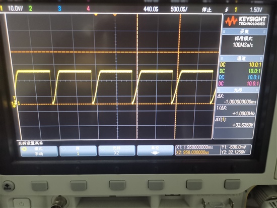

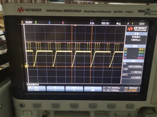

2. PWM drive problem: the gate voltage output by DRV8323 is abnormal. The input to DRV8323 is a 1khz PWM signal
The schematic diagram is as follows:
The gate voltage waveform of the A-phase upper half bridge:
The gate voltage waveform of the A-phase lower half bridge:
Phase A output waveform:

    The default configuration for the DRV8323 IDRIVE settings are 1A/2A for the SPI variant. I will need to see the schematics for the MOSFET powerstage to see the Qgd of the MOSFETs used and whether they may be extra components such as gate resistors or gate-drain capacitors.
    The waveforms showed large transient spikes on the upper half bridge waveforms and lower half bridge waveforms. A good first step to debug would be to lower the IDRIVE setting to the minimum, or a setting that would be best for the customer's application based on this IDRIVE FAQ:

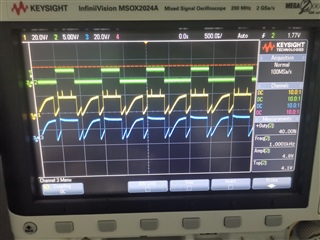

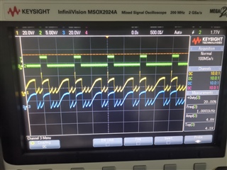

  • The customer reduced IDRIVE and the output was normal.
    But there are two problems:
    1. He gave phase A a constant duty cycle, why is the output not constant?

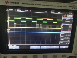

    2. Phase A and Phase B output are normal compared to before. But phase C is the same as before, it is abnormal. Before, the gate of the upper half bridge of phase C was always about 12V, and the gate of the lower half bridge was a very narrow pulse, and this is also the case now.
    Voltage waveform of the gate of the upper half bridge of phase A:
    The gate voltage of the B-phase upper half bridge (normal):
    C-phase upper half bridge and lower half bridge (abnormal):

    The customer found that the screen he replied last time had some problems. At that time, he set the 3PWM mode, and then drove in 6PWM mode. Now that it’s revised, it’s still a big problem.
    At present, SPI should be able to write data (although he can't read it). The figure below is driven in 6pwm mode. There are glitches on the upper half bridge gate voltage waveform. When he lowered the IDrive value, the glitch would be reduced, but the waveform was almost unchanged. As can be seen from the figure below, it should be the problem that the MOS of the lower half bridge is not turned on. But neither the upper half bridge nor the lower half bridge of phase C is opened.
    1. From top to bottom, it is phase A input-the gate of the upper half bridge of A-phase A output
    2. From top to bottom are A phase input-A phase upper half bridge gate-A phase lower half bridge gate
    3. From top to bottom are B phase input-B phase upper half bridge gate-B phase output
    4. From top to bottom, it is B phase input-B phase upper half bridge gate voltage-B phase lower half bridge gate voltage
    5. From top to bottom are C phase input-C phase upper half bridge gate voltage-C phase output
    6.C phase input-C phase upper half bridge gate-C phase lower half bridge gate

    Please share current IDRIVE settings used to capture above waveforms. If IDRIVE improves performance as it is lowered, please lower the IDRIVE to reduce gate drive glitches on high side of phase A and see if we get any outputs on phase C.
    I noticed there are 3 different grounds: GND, AGND, and PGND. Are these connected anywhere in the schematic? These split grounds need to ensure that in layout they are connected and that are are no difference in voltage between the ground planes or else FETs may not turn on properly.
