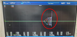

Hi Team,
My customer is testing it by applying it to 40W sealing pan.
Issue status:
1. Check initial inoperative condition when power is applied.
2. Check DRIVER IC's normal output of 5VDC, 3.3VDC, and 1.8VDC. (MCU is normal operation)
3. Normal operation when the motor is pushed by hand.
4. Check abnormal behavior of more than 5EA of the 10EA board.
Bad waveform :
Good waveform :
Please find the schematic and PCB that needs to be improved.
Sechmatic_Rev0-4_Up.pdf
Gerber REV0_4.zip
