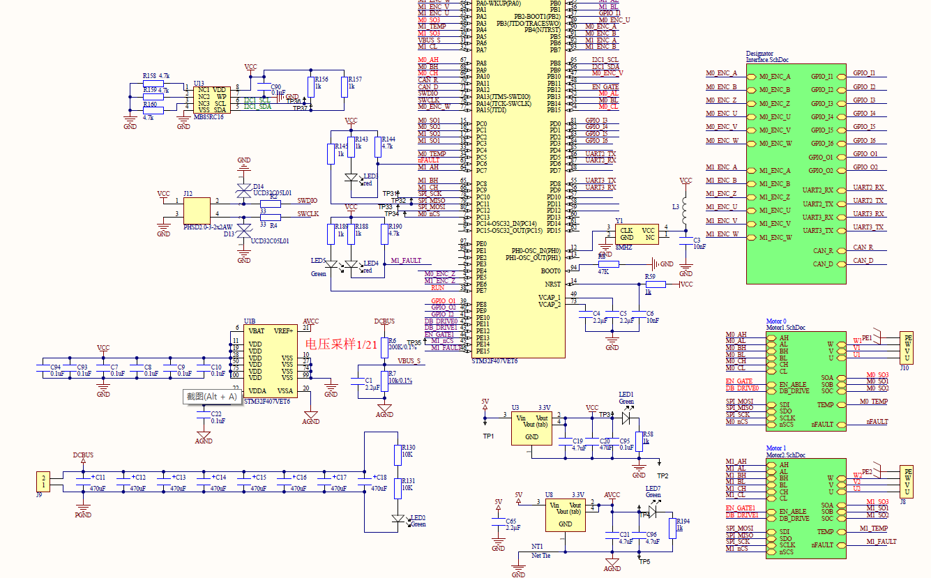

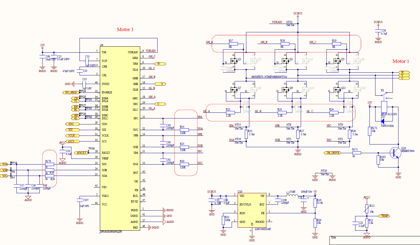

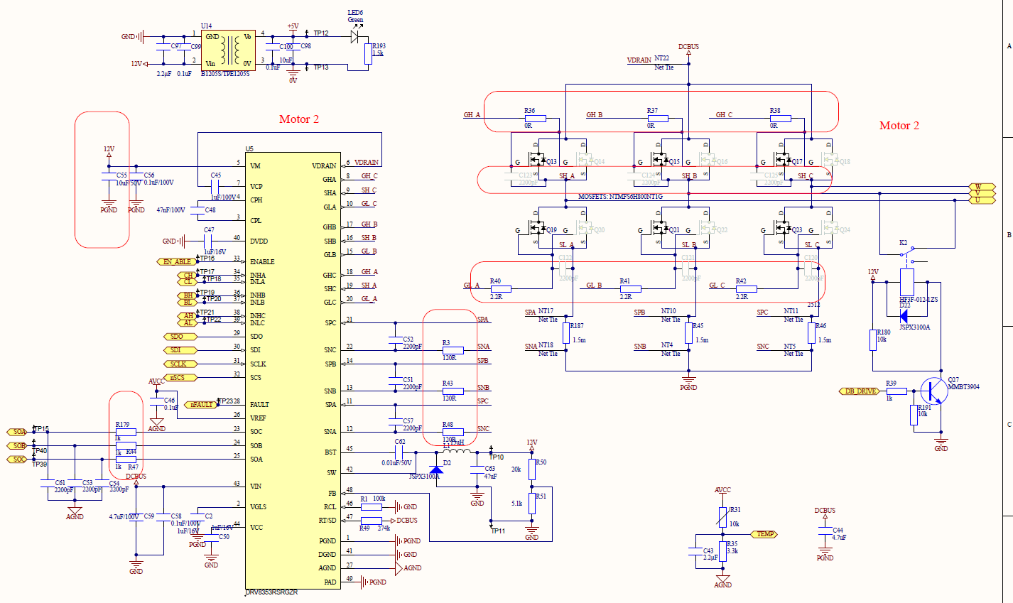

    Please see the registers and schematic as below.

    Based on your IDRIVE settings the rise time seems to be slightly high at about 160 ns with a 100mA IDRIVE setting. I would recommend lowering the IDRIVE slightly.
    I noticed that you have C45 rated to 100V, this is not necessary can you could use one rated at 25V.
    I would also like to make sure that you have a pull up resistor on nFAULT and SDO.
    My biggest concern is in regards to the different grounds you have on PGND, DGND, AGND. Having these grounds connected to different ground planes can cause current loops.
    On the MOSFET side, I see that you have the FETS that are not populated, but they are in parallel with the FETS that are populated. I’m assuming you will add these FETS later. I highly recommend putting a small resistor in series with each gate so they don’t oscillate between each other when they turn on. Also, I would like to recommend to add cap (.01uF-1uF) between each high side drain to low side source. Also, set a much lower OCP threshold. 1V is way too high to protect the system.
