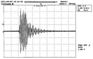

Customer is using DRV2605 to drive LRA. They used Strong Click - 100% effect in the waveform library with closed loop setting. The waveform is like below.
They expected more sharp braking. Is there any way to make more sharp braking?

  • Hello Saito,
    You can change the FB_BRAKE_FACTOR to a higher value but larger braking gains can lead to less-stable operation so be sure that it is set to as small a factor as possible to achieve the desired braking here.
