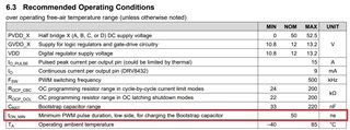

    Please tell me the test condition of Ton below.
    What are the values for G VDD, P VDD and bootstrap capacitors?
    I sent the abnormal waveform to a private message.
    Please check there.
    Ishiwata
  • Ishiwata,
    1. Test condition of ton_min: when the output current cannot reach the regulation point (put a high resistance load on the output), DRV8412 will push the duty cycle as much as it can. In this condition, we can find the ton-min.
    2. In the datasheet figure 8, each PVDD_x capacitor is 100nF, plus 100uF bulk capacitor; G_VDD_x is 1uF; the bootstrap capacitor is 150nF.
    Wang

    About 1:
    I understand the measurement of Ton_min. Did you confirm Ton_min = 50nsec described in the data sheet by measuring with EVM?
    https://www.ti.com/tool/DRV8412DDWEVM
    Also, I think that Ton_min = 50nsec described in the data sheet is a value that should be guaranteed.
    What are the conditions for the guaranteed value? Or do I understand that it can guarantee all bootstrap capacitor and PWM frequency conditions?

  • Ishiwata,
    1. For bootstrap circuit, if the PWM duty cycle allows the low side FET turn-on longer than 50ns, the Ton-min naturally happens. We don't need to guarantee anything. Ton-min is a typical number. I am not sure what do you want to guarantee.
    2. It is hard to know what issue they have right now. (why do they think it is Ton-min issue?) Can they get an EVM to confirm the issue with their load?

    If we give 100% PWM duty cycle or the output current cannot reach the regulation point, we could see 50us Ton_min. According to datasheet description, "For applications with lower than 10-kHz switching frequency and not to trigger BST_UVP protection, a larger bootstrap capacitor can be used (for example, 1-μF capacitor for 800-Hz operation)." In this case, the duty cycle is about 1-50ns/1.25ms= 99.996%. I am not sure it can mean anything to the customer.
