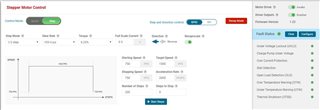

I was evaluating DRV8889-Q1 EVM with 17hs19-2004s1 stepper motor. Everything is working fine except for the following -
1. STEP_SIZE
It seems the motor is always executing the same step length, irrespective of full or 1/2 or 1/4 etc.. step sizes set in GUI.
360 degree move
I am seeing a 360 degree rotation for all the step sizes. Should the total angle covered by motor reduce when step size decrease ?
Am i missing something here ? Please help.
2. FAULT CLEAR
The fault clear is not working in GUI. Always i have to asleep & awake the motor_driver toggle switch. Any thoughts on this?
