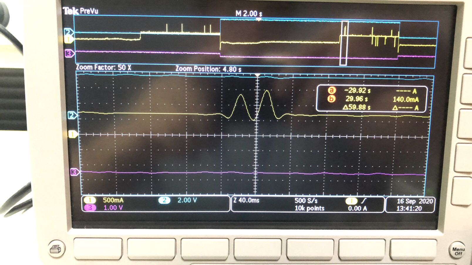

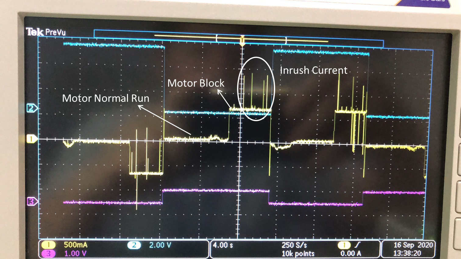

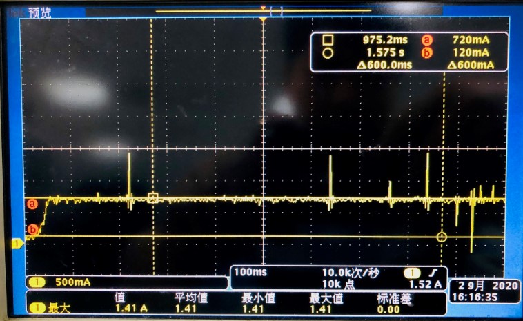

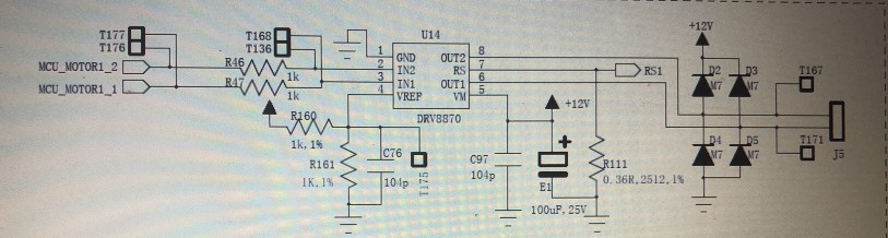

We use DRV8870, Rsense = 0.36, Vref = 2.5V, target current limit is 700mA. SCH is as below.
But when the motor is blocked and keep blocking there, the current waveform measured @J5 is as below. Very confused why the current looks like this and does below block waveform normal?
