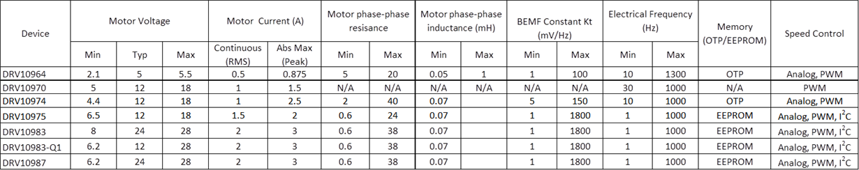

This FAQ can be used as a quick guide to select the right DRV10x device for your application based on design input parameters and motor parameters shown in below table.
