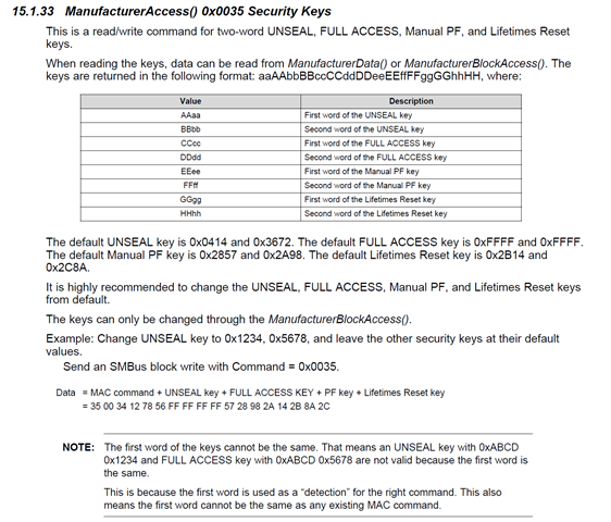

Hello TI Expert,
I would like to know BQ40Z50 Device, default Sealed code change to custom Sealed code in Advanced Comm SMBus tab in BQStudio?
Please advice steps to the send SMBus commands to create a custom sealed code for the device.
Suresh
