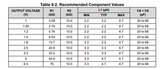

Is the recommended output capacitance range mentioned in datasheet nominal or derated capacitance?
Hi Jaakko,
Please make sure the capacitance after degrading can satisfy our recommended capacitance range, then there will be no concern for stability.
Jiandong
