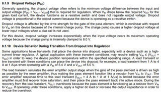

2) Behavior when Vin < (V_OUT + VDO)? During high current pulse and low temperature condition, I guess my battery voltage could go below maybe 3.6V. If the LDO was set to Vout=3.7V what would happent then? Undefined behavior? I just need Vout>3.3V in this case.

    As for your second point, your LDO will track Vin if Vin were to fall below regulation.
    Vout = Vin -Vdo. Vdo = dropout voltage, which scales with your load.
    Note: If your battery were to recover, your output will overshoot-as is typical of any LDO performance.
