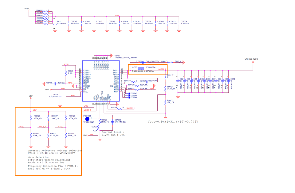

My customer is using our TPS548B22 and the schematic is as below.
I have checked it and would like to have your double confirm.
Would you have any suggestion about it? Thanks.

Generally the schematic looks very good. A couple of minor things that I would suggest for improvement.
1) For a 12V input, I would recommend increasing R9918 from 1-ohm to 10-ohms. VDD does not need to be the same voltage as PVIN and increasing the filter resistor will help reduce the noise on the VDD pin.
2) I calculate that meeting the 1ms soft-start time will require at least 6A of output current during start-up due to the combination of high output voltage and output capacitance. This is well within the TPS548B22's capabilities if the ouptut load is limited, but it's a fairly large amount of no-load current if the 1ms soft-start time is not critically needed.
I reviewed the schematic and the selection of components is good for a 12Vin to 3.75V design. I verified the component selection using our device calculator and the selection if balanced for performance. One suggestion I may have is to include a 0 ohm resistor in series with the RSN pin to allow the layout to include a differential sense tied to the point of load. The soft-start time is fast given the amount of output capacitance and output voltage, but the customer can support a startup into a load of 23.6A given the current limit and current needed to charge the output capacitors upon startup. Please reach out to me regarding any further questions.
