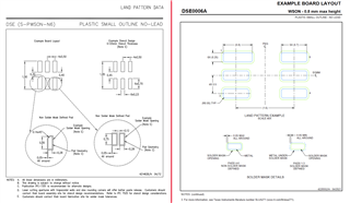

I am working on the design with the BQ2973 and when reviewing the footprint noticed that the footprint doesn't cover the entire pads of the component. Looking at some older datasheets with the same footprint shows a different recommended footprint prior to April 2021.
I'm just curious if was there was a reason for this changed as it seems the previous footprint seems better at a glance.
