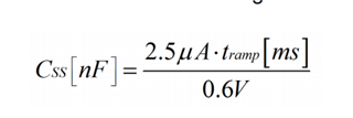

    TPS62813-Q1 device soft start up equation will help to evaluate the tramp time.
    According to soft start up capacitor selection you can vary it. Current EVM is set for star up time of populated with 4.7ns soft start up capacitor(Css) and according to that the soft star up time set is 1ms.

  • Hi Tanvee,
    The SS time is internal VFB ramp time. Is this SS time similar to Vout build time?
    Roy
  • Hi Roy,
    Output voltage build up depend on soft start up and enable pin configuration.
    If enable set high then after typical  delay of 200us vout starts build up according to slop set through soft startup capacitor and estimated of output voltage would be similar to soft start up capacitor selection.
