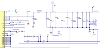

  • Hi Alec san
    I want to check the frequency characteristics using FRA (Frequency Response Analyzer). Is TPS543B20E possible?
    If possible, as you know, the FRA should inject the signal at the OSC.Normally, a signal is injected between the output and the FB resistor. Where should I inject ?

  • Hi Suzuki,
    On the schematic you shared, I would recommend changing the R13 to a 10-50ohm resistor and injecting an AC frequency sweep at TP11 and TP12.
