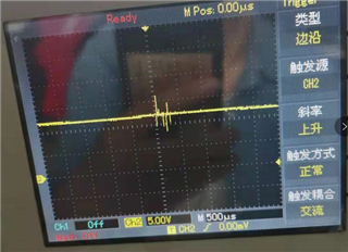

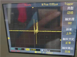

Hello, everyone. There is a problem of power interference. However, it interferes with the operation of our products when plugging and unplugging other electronic products. Our product is 12V to 3.3V; 3.3V to 1.2V. The oscilloscope captured the 1.2V waveform
  1.2v
 12V
 3.3v

    These measurements seem to have picked-up some noise.

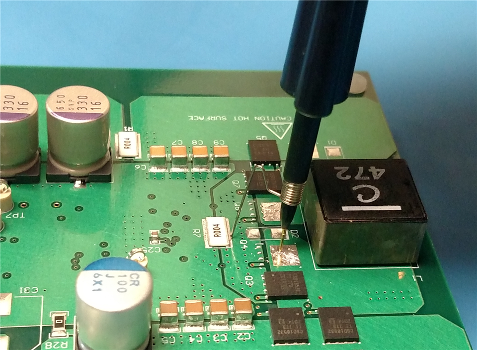

    1) Have you used a "Tip & Barrel" scope probe connection for these measurements?
    The standard oscilloscope ground lead connection will pick-up a lot of noise in such measurements and is not recommended.
    I am afraid that these measurements need to be captured again with the proper "Tip & Barrel" scope probe connection.

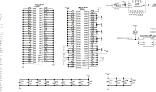

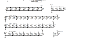

    The circuit diagram is as follows
    You can make your own "Tip & Barrel" connection by winding a thick/rigid wire around the ground connection of your standard probe.
    Please look on the web and search for "Tip & Barrel", this type of connection is common practice in power engineering debug/test.
