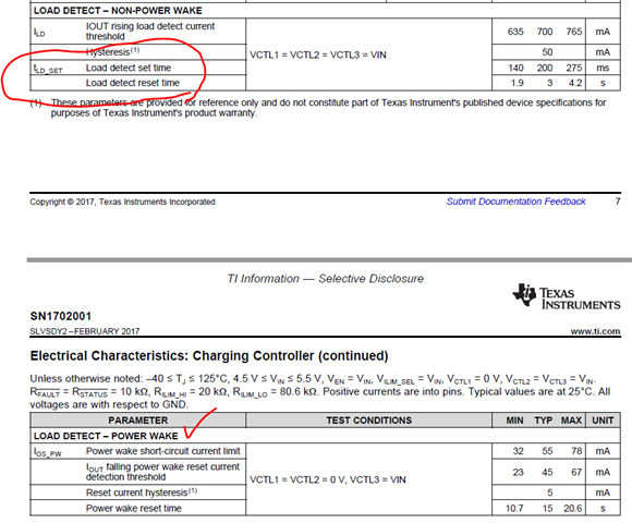

1. What's meant for load detect reset time?
2. Section 7.7 doesn't show the set and reset time for power wake, what's those value ?
Thank you
In both of the tables you shared, you will see that the center column says Test Conditions. The test conditions outline the configuration the TPS2546 must be in, which is determined by the voltage applied to the CTL pins. The load detect for Power wake is less than non-power wake, as the power wake functionality is intended to be used to wake the system and inform the system that a device has been connected. Non-power wake would be used in a S0 power state
The power wake reset time is the amount of time it take for the STATUS pin to go back HI, indicating that there is no longer a load attached to that port

Thank your reply, but I would like to know the load detect set time for power wake. Could you tell me the specific value?
As the table, load detect set time - non power wake is among 140~275ms. However, load detect set time - power wake?
Thank you!!
Hi Eddie,
Unfortunately we do not have a parameter for this within the datasheet.

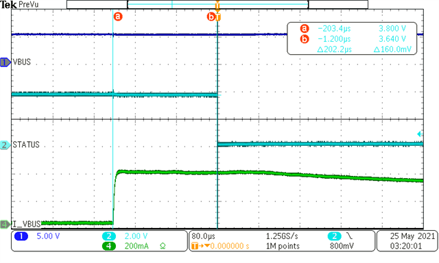

Hi Eddie,
You can see from the image that it takes at least 200us before the STATUS pin goes low in the load detect power wake configuration

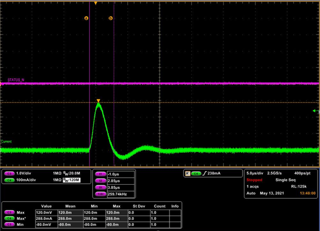

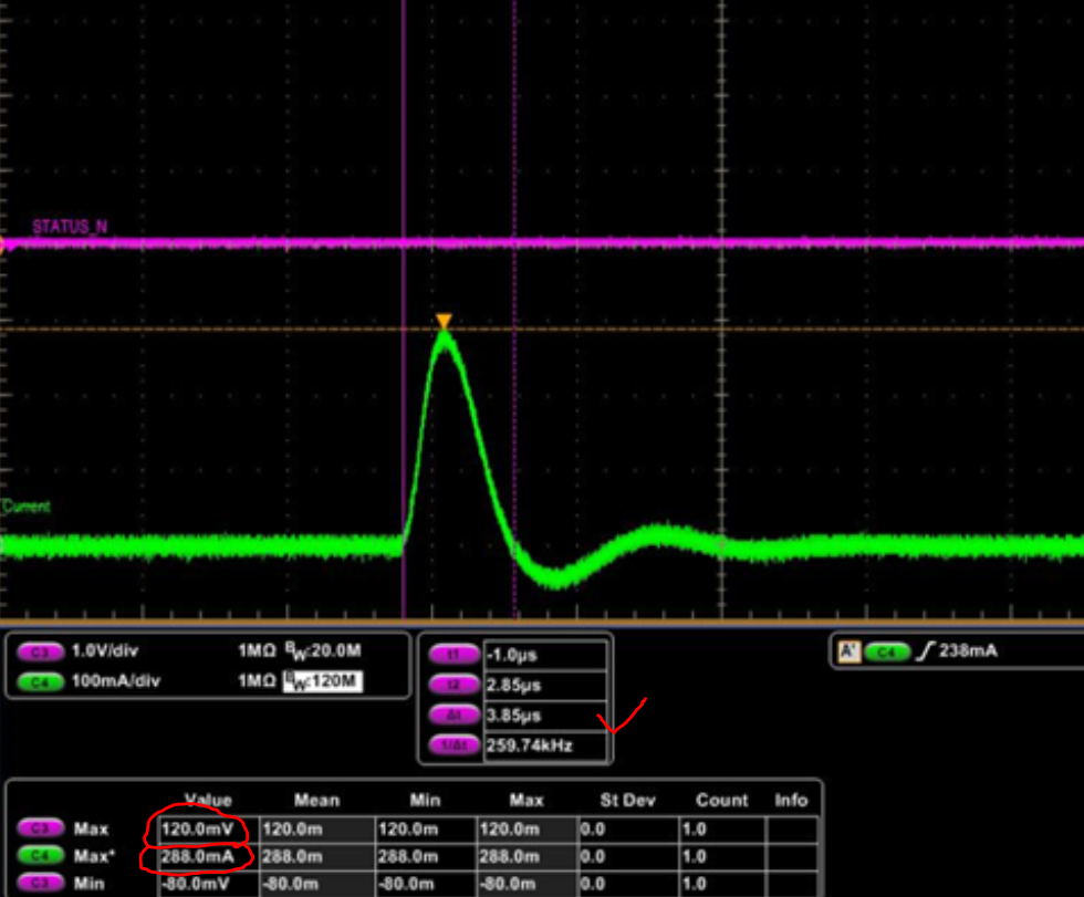

If your measurement is that I_VBUS should take 200us over the threshold before the STATUS pin changing. However, the below picture seems not matching your result. There is a periodical current spike which over threshold but less than the 200us why is the STATUS pin asserted?
Geen: I_VBUS; Purple: STATUS; 3.85us over the threshold; I_VBUS Max: 288mA, STATUS: 0V
I would like to know what is the minimum duration of I_VBUS over threshold causing STATUS pin changing??

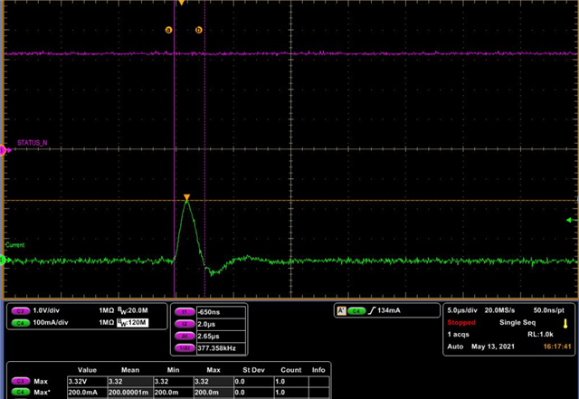

In your waveform, the I_VBUS is near constant value but my customer met the problem is current surge.
Thank you
Hi Eddie,
You can see that the STATUS pin is already low when the current spike is seen. So something is occurring before the current spike in this measurement. The current spike shown in the measurement is not causing the STATUS pin to go low
Is this current surge being seen when no adapter is connected? If so, then that is the problem. Why are their transient current spikes without any device connected. If this current surge is from a connected device, then wouldn't the system want to know that a device has been connected?

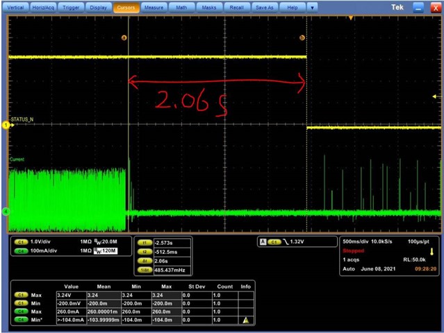

Please, check the waveform. Fig1. Green is Iout and yellow is STATUS. TPS2546 sets to 0011.
After 2.06s of the system into S5, STATUS pin change to low.
Why is each current spike duration below 200us which still caused STATUS keep in Low?
Hi Eddie,
You can see in the electrical characteristics for the power wake mode, that it has a typical reset time of 15 seconds. So the STATUS pin could eventually be going back High, but it does not show in your capture.
