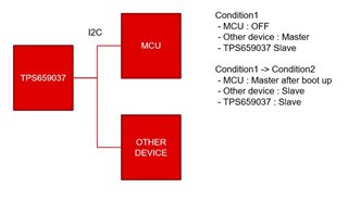

    There are 3 devices that are TPS659037, MCU and other device in the I2C line as below.
    First, Other device work as Master during MCU off state and then MCU work as master after boot-up. After MCU boot-up (release RESET), other device work as slave device.
    Can other device as master access to TPS659037 ?

    Any device should be able to communicate with TPS659037 as long as that device is connected to the same I2C net and utilizes the proper address. TPS659037 will not know which specific device is communicating with it and will respond in the same way in either scenario.

    RESET_IN is not a valid ON Request and will not result in the device being powered on unless a different ON request is present. I would recommend reviewing Table 5-9 of the TPS659037 datasheet. I2C is not available until the device has completed power up.
