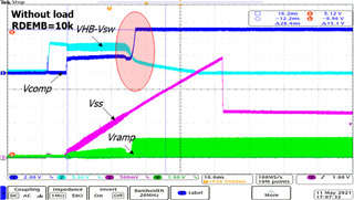

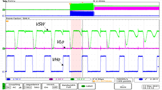

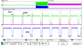

When I use the Lm5116 IC, I found that if there is no load, the voltage will drop directly from the 24V I preset to about 3.6V, but it is normal when there is a load.
During the observation, it was found that the inductor has a reverse current that causes the high side diode to turn on and low side turn off. At this time, the bootstrap cap cannot be charged, and the output
slowly becomes 3.6V. But I don’t know what caused this situation.
Vin=30-60V
Vout=24/2A
Fsw=200k Hz
LM5116 Circuit-Dylan.pdf
When I tried to change the low side resistor from 33 ohm to 0 ohm, the output 24V does not fall down.
