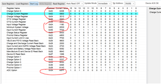

    This is your register change from default power up:
    On my test, VBAT ~ 12 V, Vadapter = 13 V. System load is ok at both 6 A and 7 A. VBUS is still providing all the current.
    I recommend checking your input source as well as your hardware connections. Any adapter unplug and plug in will result in input current limit and charge current to reset. MCU intervention will be needed after any adapter reset.
