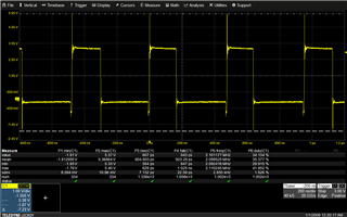

This is the waveform when Cff is 68pF, and the output capacitance is 50uF. When there is no load, the duty cycle of the SW port is already unstable. When the output electronic load is 1.2A, the waveform of the SW port is also unstable.
When the Cff is changed to 10pF, the duty cycle waveform of the SW port is very stable, but as mentioned above, the positive margin of output voltage is not better at this time, so can you provide the calculation formula for Cff?

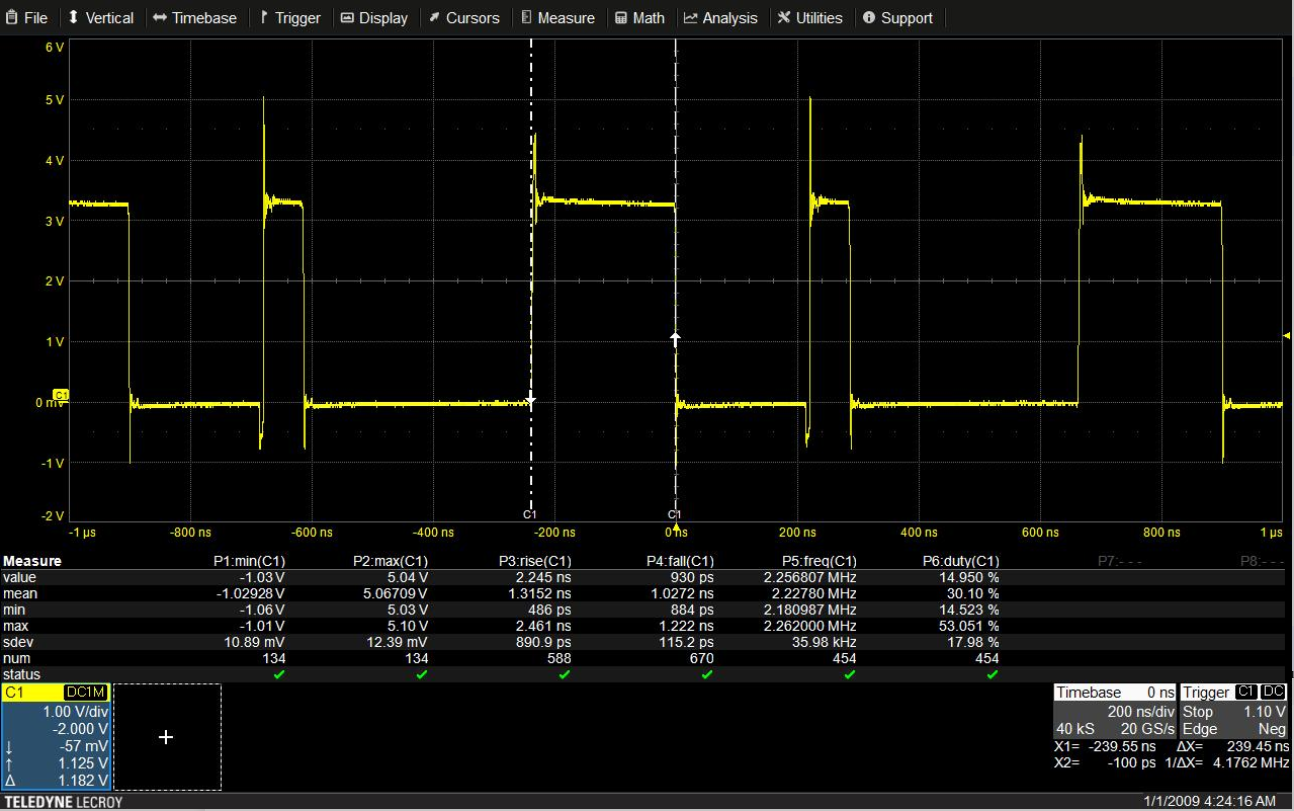

We have adding 1 more 10uF Cout, but the waveform of the SW port is also unstable. Because when there is no load, the waveform of the SW port is also like this, which is unstable.
If changed the Cff to 10pF, the waveform of the SW port is very stable.
The waveform of Cff (68pF)
The waveform of Cff (10pF)

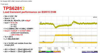

Ah, ok. Thank you for explaining.
Your circuit here looks very different from the circuit in that ppt slide: both FB resistors are different, the inductance is different, and the output cap is different. That slide should not be read as a general statement that a 68pF Cff is better than a 10pF one. Which Cff value is best entirely depends on the exact circuit being tested.
