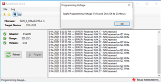

BQ27220EVM-744: BQ27220EVM-744 prompts ERROR NAK during programming

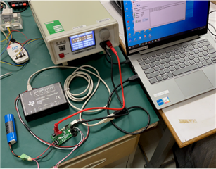

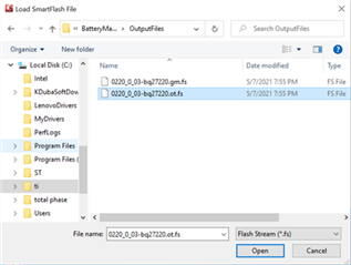

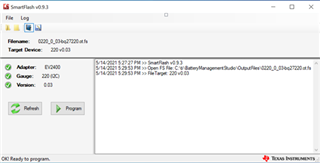

we changed the battery capacity and battery voltage from BQ studio, and then generated a programming file, and then connected the EVM of BQ27220, battery, and EV2400. Through Launch Smartflash Software, we can connect to the EVM of BQ27220 normally. After clicking the program, A dialog box prompting to connect 7.4V will pop up. Manually connect the 7.4V voltage, but the programming still cannot be completed.
