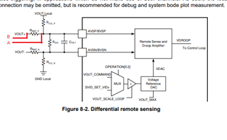

1. The D-CAP+TM Bode Plots Measurement Setup
    What is the correct amplitude and point of signal injection for TPS53688?

  • 1- Please refer to the sketch below.
    2- Typically we recommend at least -6dB gain margin for DCAP+ converters.
    Also, while the TPS53688 allows compensation tuning through I2C/PMBus, it is still an analog control loop. Like when you change the DC Load line (VOUT DROOP), the device adjusts an internal resistor DAC, instead of an external resistor.
