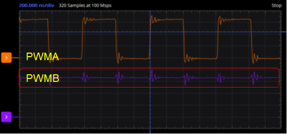

I am using UCD3138ACCEVM149, ready to drive a LLC circuit.
I modified the demo program from trainingLab 3.
by changing the cpusample value, i can see the output PWM signal changing from 500KHz to 2MHz, that is working as I expect (PWM0 module).
while the problem is
PWM0A pin is always good,
but the PWM0B sometimes is good, some times is HI level.
I mean during the frequency of 500kHz ~ 2MHz, Pwm0B is good at some frequency, but output HI level at some other frequency.
I am confused,
would you please give me some advices on what could be the reason of it?

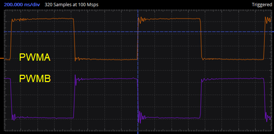

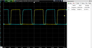

  • Hi Xiaofeng,
    I ran your code many times, but I could not duplicate the issue. Here are my results (Blue line is 0A, Yellow line is 0B):
    ram_cpu_samples = 255:
    ram_cpu_samples = 0:
    As you can see the signals appear to be normal. I did not see an instance where the 0B stayed high in my case.

    and here is the wave forms for the issue.
    By the way, I found another problem.
    in my case, even when the PWM0B is good, the deadtime looks like to be zero, that is also different from your result.
  • HI, Bower
    thank you again!
    I paste 2 waveforms at the reply upper, hope it will help you to understand my issue.
    I always changing the frequency in the memory debugger of UCD3xxx GUI.
    I am wondering, if the code is the same, and no problem on hardware, the building configuraion could be the reason.
    do you got any other idea?
    with regards!
    Xiaofeng
