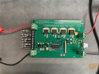

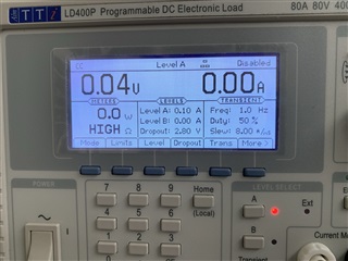

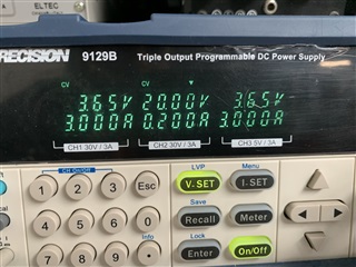

I encountered an issue with the evaluation module board when I'm trying to follow the instructions of the section 4.5 Basic Operation of the user guide.
I'm supplying 20V for the BATTERY side.
When I link the PACK side to the load, I cannot see any voltage, whereas in the meter tab of the power supply I can see there a voltage.
The resistors used are 100Ohm ones, is it a problem ?
Thanks in advance for you answer,
Evan

  • Hello Matt,
    As written in the datasheet, the 20V are supplied on the BAT side and the load is linked to the PACK side.
    I noticed that the opposite works, if the power supply is linked to the PACK side and supply 20V, I can see the voltage (19.47V) on my load linked to the BAT side.
    For you second question, I think that it's linked to the price of the EVM (our final purpose is to create our own protection module).
    Thank you,
    Evan

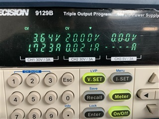

  • Hello Matt,
    First I bought 180 Ohm resistors and replaced the old ones.
    I did the step 3 in the basic operation, I supplied 9V on the PACK side and the Communication starting but an Under Voltage was detected.
    There were still 20V supplied at the BAT side.
    Is there a certain amount of current that we have to provide on the  BATTERY side or on the PACK side ?
    If you have any idea please let me know.
    Thank you for your help.
    Evan
