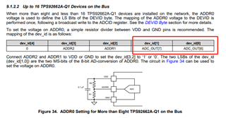

I want to ask the ADC pin, When the number of devices is more than 4, I need ADC pin to set the address of the device, Two bit data to occupy ADC out, At the same time, I need to use the ADC pin to enter the detection LED code. ADC is 8 bits,Two bits are occupied when setting the device address,Can I still use ADC pin to detect analog input signal?
To sum up, can I use ADC as NTC input while setting device address with ADC?In other words, after setting the device address with ADC, ADC can no longer be used as the input of analog signal, because 8-bit ADC is occupied, two of which are used as the address setting.
