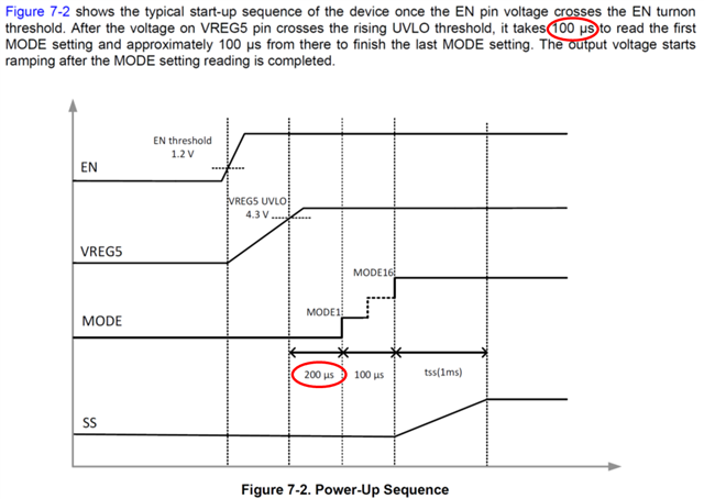

I received some questions from my customer about power-up sequence for TPS56C215.
1. Whitch correct the delay time of VREG5 to MODE is 100us or 200us?
2. If 200us is correct, why did the read start delay time from VREG5 to MODE change when changing the datasheet from Rev.C to D?
The delay time in the datasheet Rev.C was 100us.
