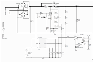

Hi Team,
There is good news that we DIN UCC28056B!
Please help review the SCH ,THX
  • Hi Cheng,
    thanks for promoting UCC28056.
    The schematic looks good to me.
    and below I have two suggestions:
    1: leave a SMD cap in parallel with C202 in case we need to find tune the parameter.
    2: use UCC28056 calculator in the TI website to design the key parameter like PFC inductor value( in the schematic is 310uF, please confirm whether it is  correct)
